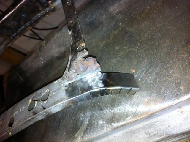

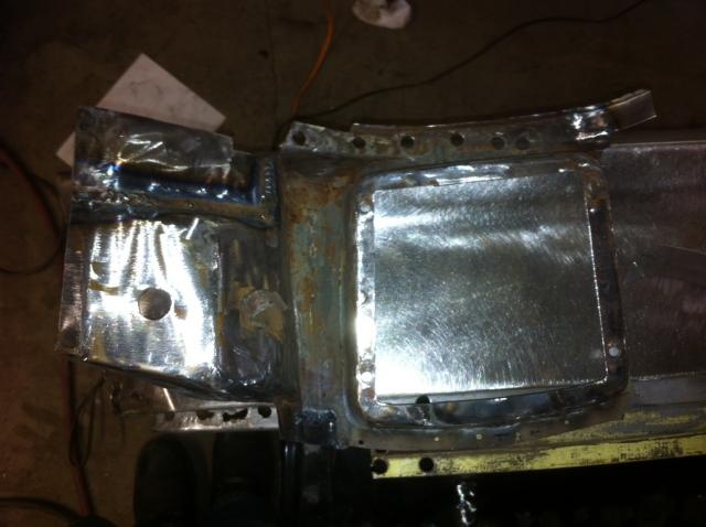

I made some patches for the trunk gutter. ready to weld up.:headbang: Kinda feels like Ive been doing rust repair for a couple years lol!
Been doing some more hand fabrication. It is tedious work! Ive got the dutchman panel pretty much repaired now and am about to finnish up the left trunk gutter.

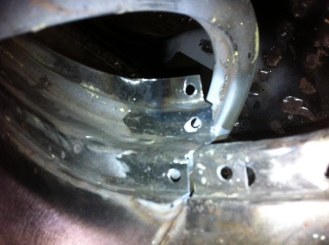

Also been working on the tail light bucket. I decided to give up on finding a new one and fix it myself.
Ive been doing more work on the tail buckets and trunk gutter. Slow but steady she goes! lol :glasses7:

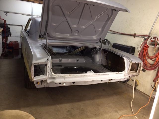

Some update pics of what i got done b4 Chicagoland turned into the north pole lol.
Trying to get my hodge podge of aftermarket and used parts to line up on the tail of the dart. I wanna get them close b4 i attempt installing my new quarters. I see lots of body filler in my future lol!

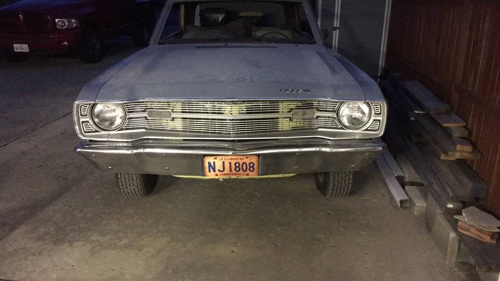

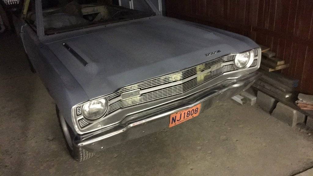

Attempting to restart stalled project. Bought a house moved . I have a new bigger garage now. More space to work. Trying to dry fit a bunch of parts I've acquired over the years. I bolted in the grill. It kinda looks like a car now lol!
