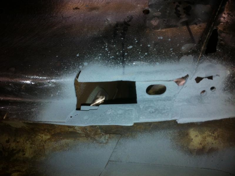

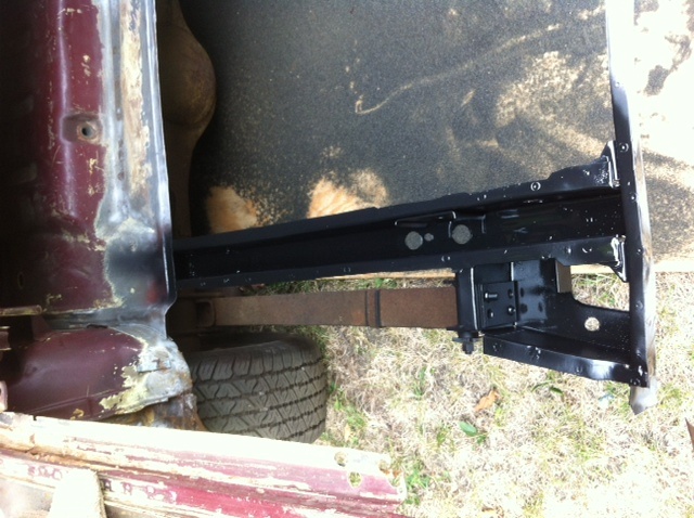

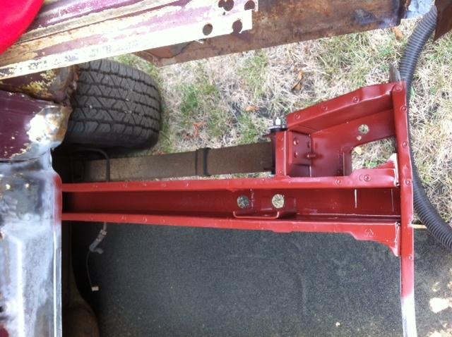

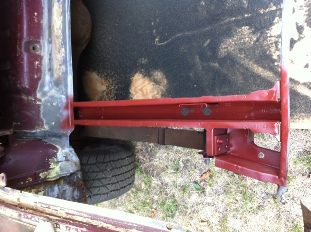

I sand blasted primed and painted the inside of the frame rails.Plan on finally getting that trunk pan welded in this week.

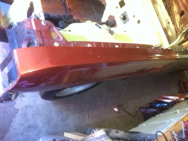

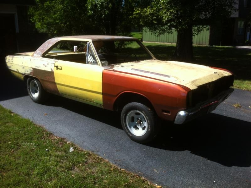

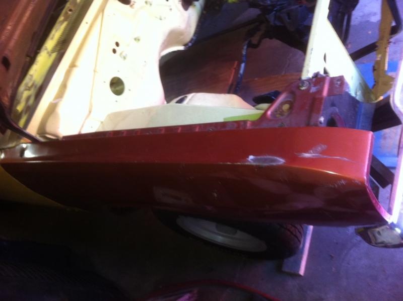

I threw the new fenders on to see how they fit. Not too bad :glasses7:

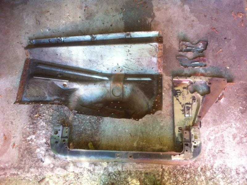

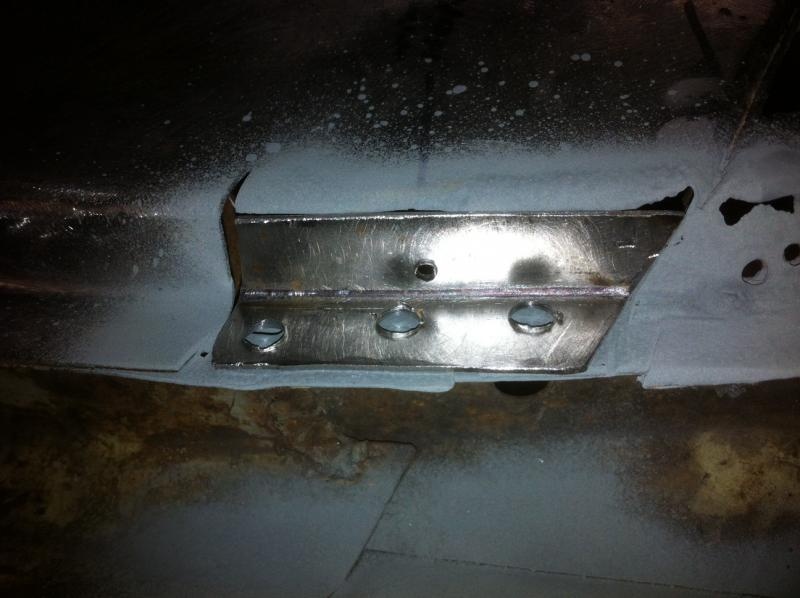

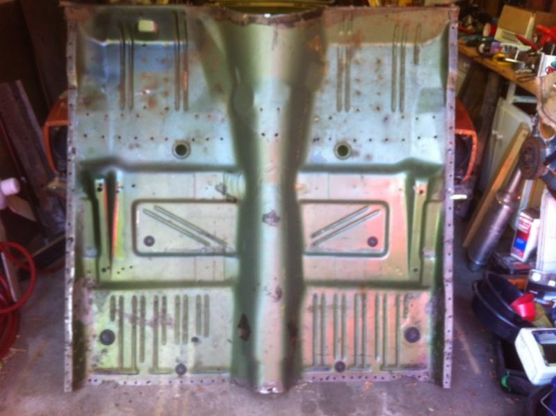

Here's some pics of me working on the trunk floor .I fit the pan int the car where i was happy and then traced around the frame rails with a pencil .I then slipped it over the old floor pan and marked where all the old spot welds where to make it as close as possible the way Chrysler did it :glasses7:.I then drilled 5/16 holes for plug welds. The AMD trunk floor is nice but its pretty much designed for the 70's up darts. the hole for the gas tank filler tube is not correct for 67-69. I made a patch from my old floor and welded it up. Not perfect but it will work :cheers: .There are a lot of spot welds holding that floor in! I also plug welded in the gas tank strap bracket.:cheers:

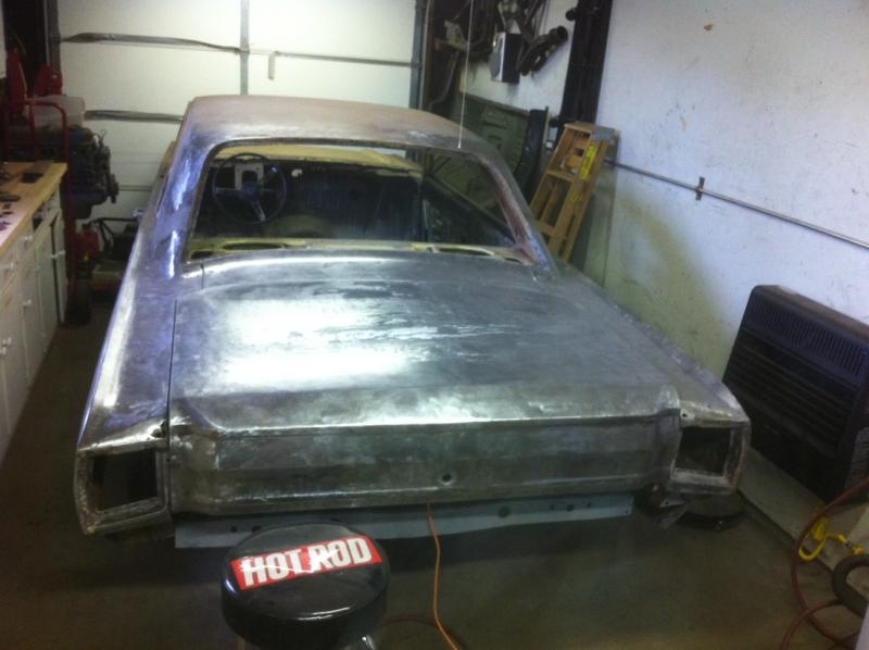

i sandblasted and etch primed my tail panel the other day. i wanna screw the whole back end together before a weld to make sure all the gaps are good.

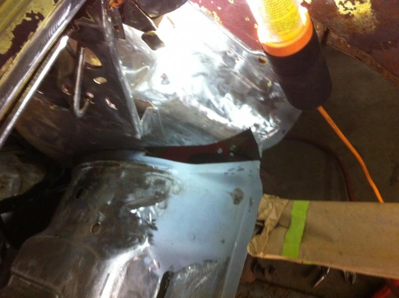

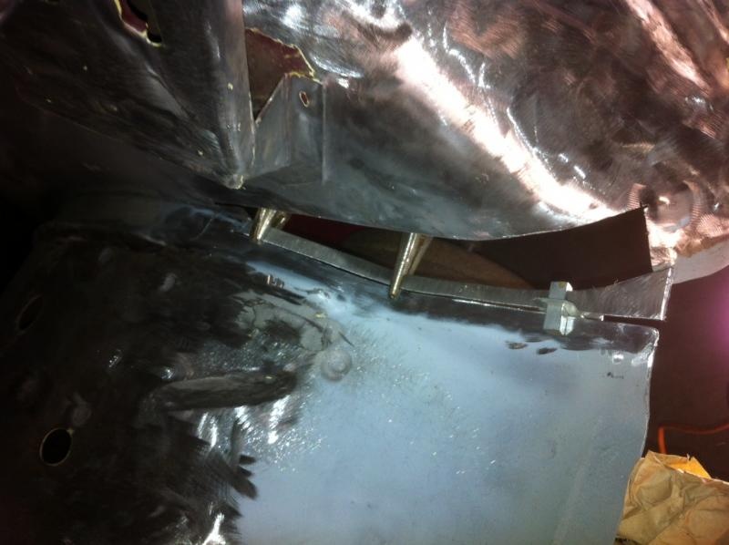

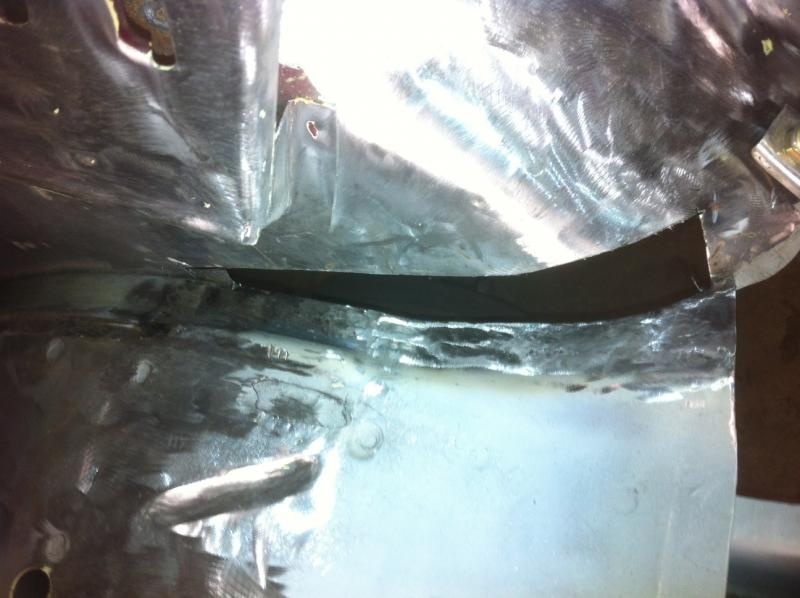

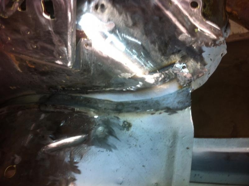

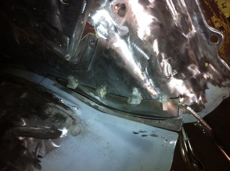

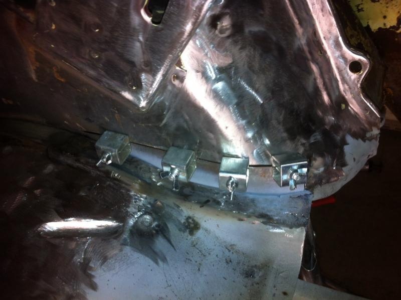

After a long break I'm working on the Dart again :cheers:. I decided to leave the trunk floor out for the time being to make it easier to do some other repairs. I did some metal fab and repaired some rust on the right inner wheel well.

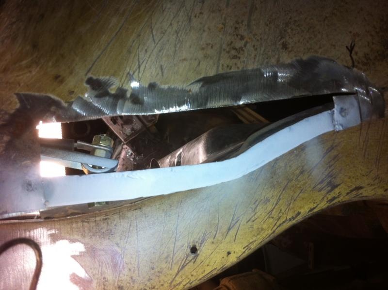

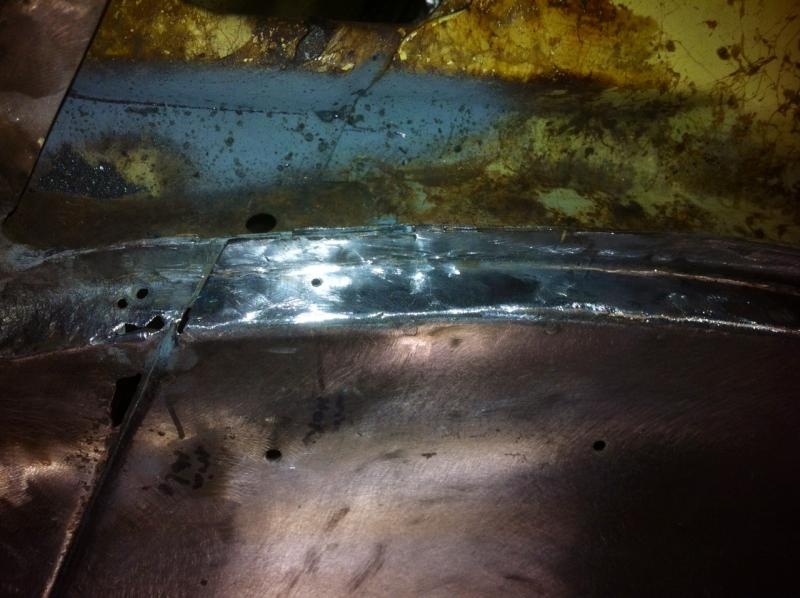

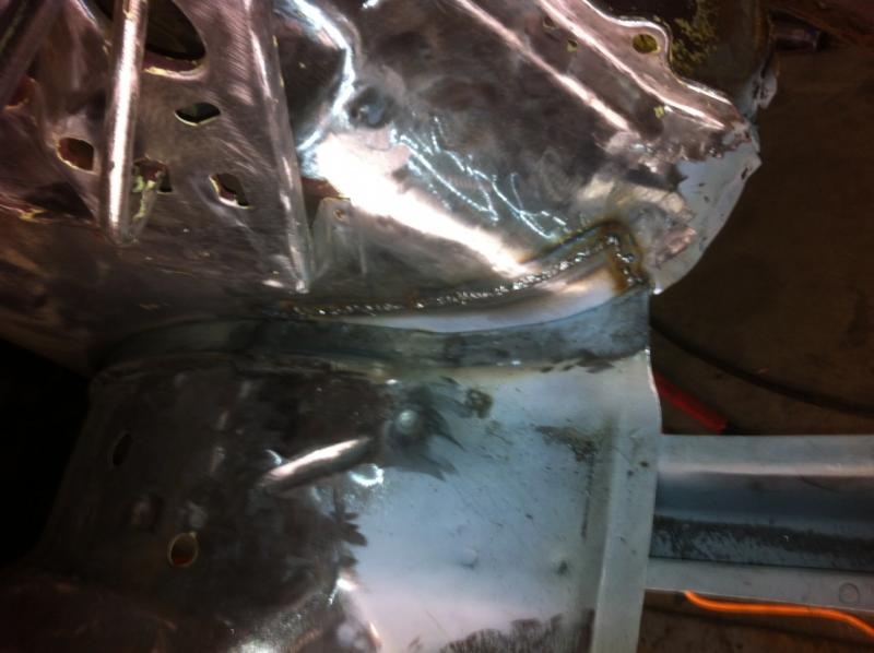

I finished up the welding. Not my best welding job but im pretty proud of my metal fabbing skills 8) .

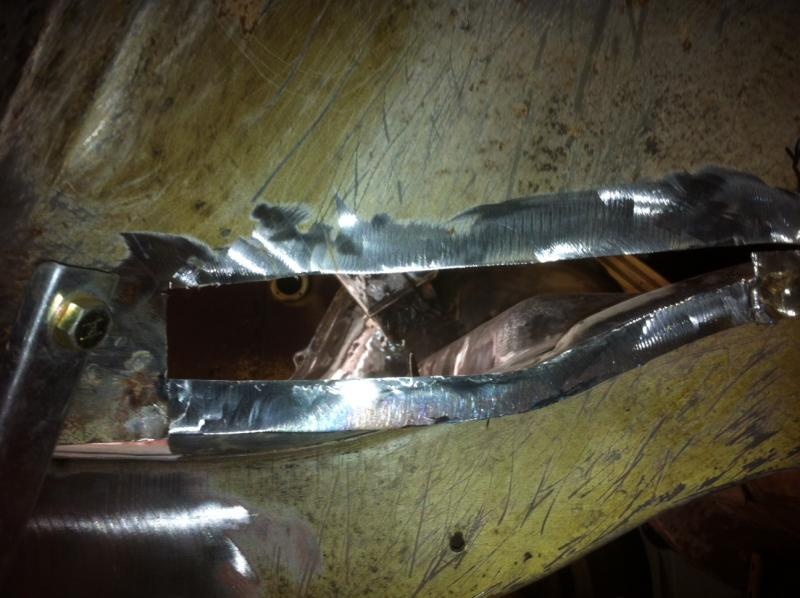

Been working on my rusty window channels. Vinyl tops look great on old Mopars but they sure do cause a lot of rust!
