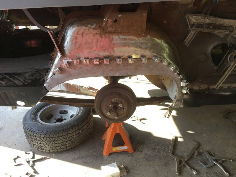

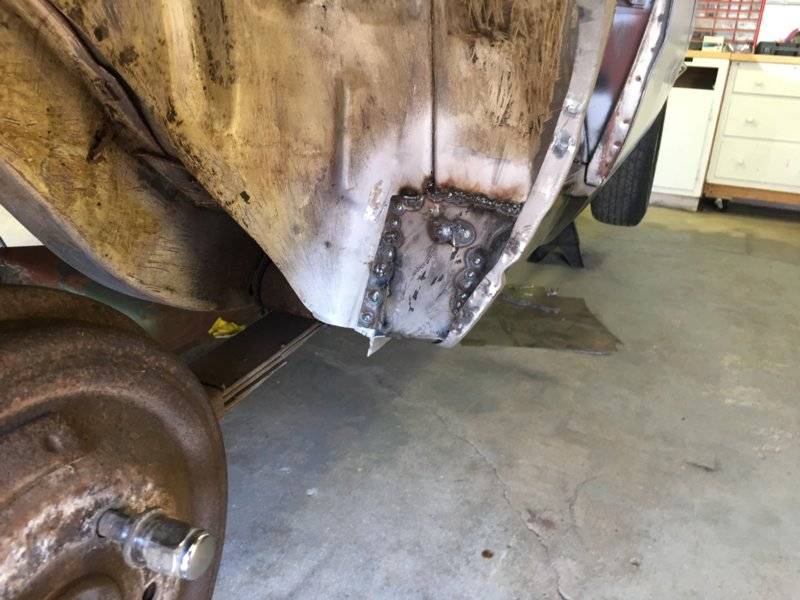

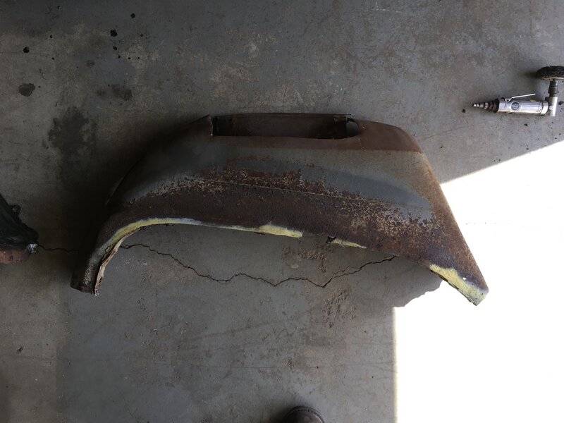

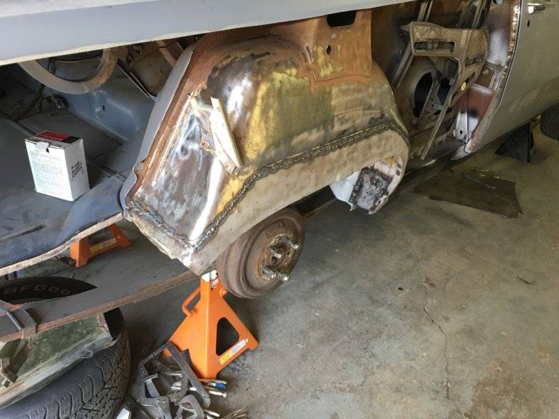

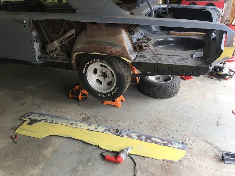

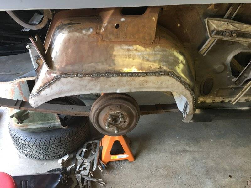

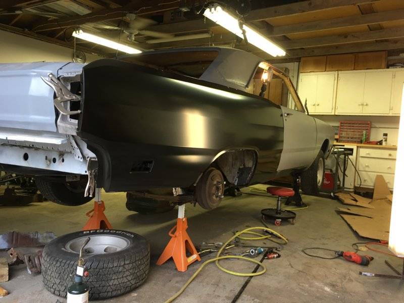

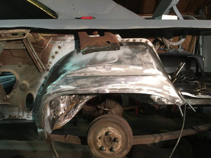

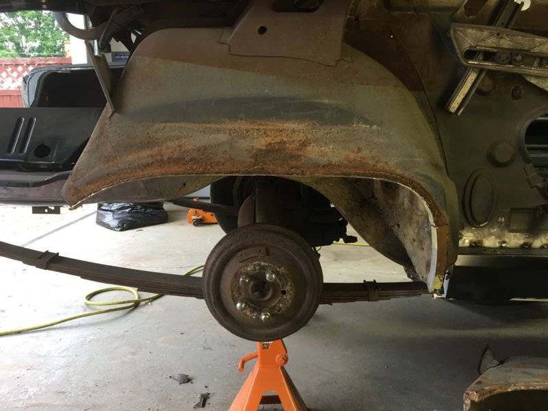

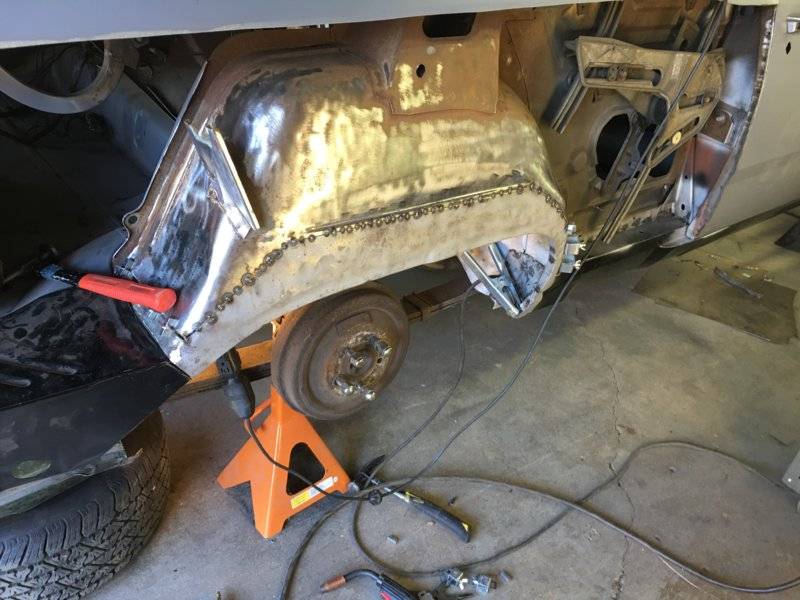

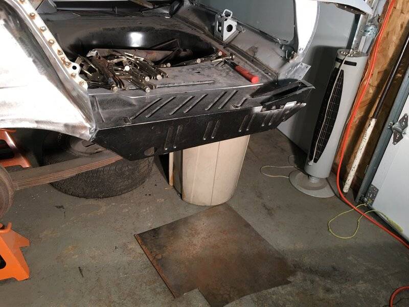

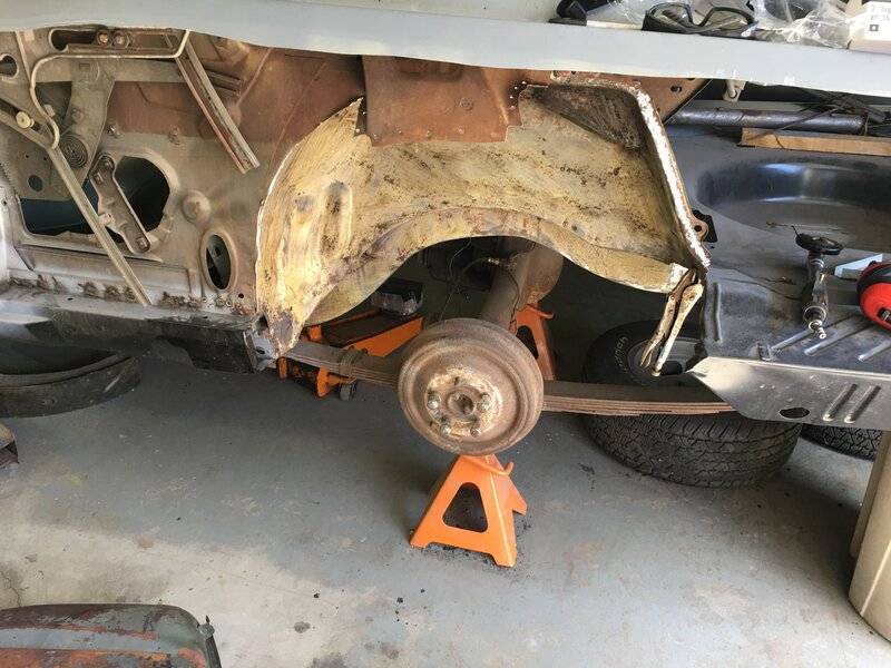

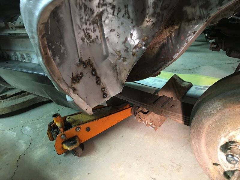

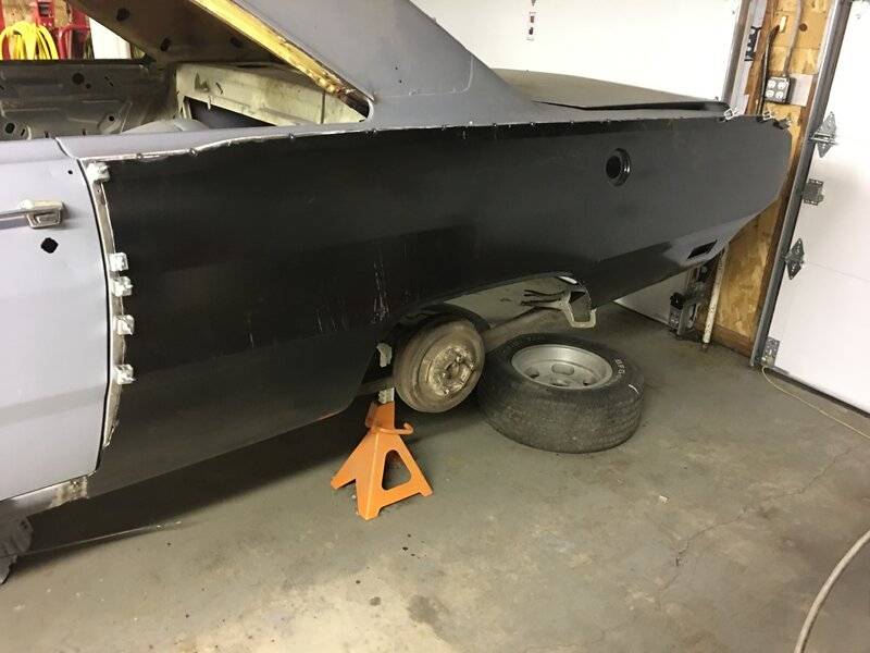

Great job!Cut off what was left of the drivers quarter panel skin. Started removing the outer wheel well . That sucker is a bear to get out. I believe they were designed to be removed in one piece . Hopefully I can be fitting the new quarter skin this weekend!

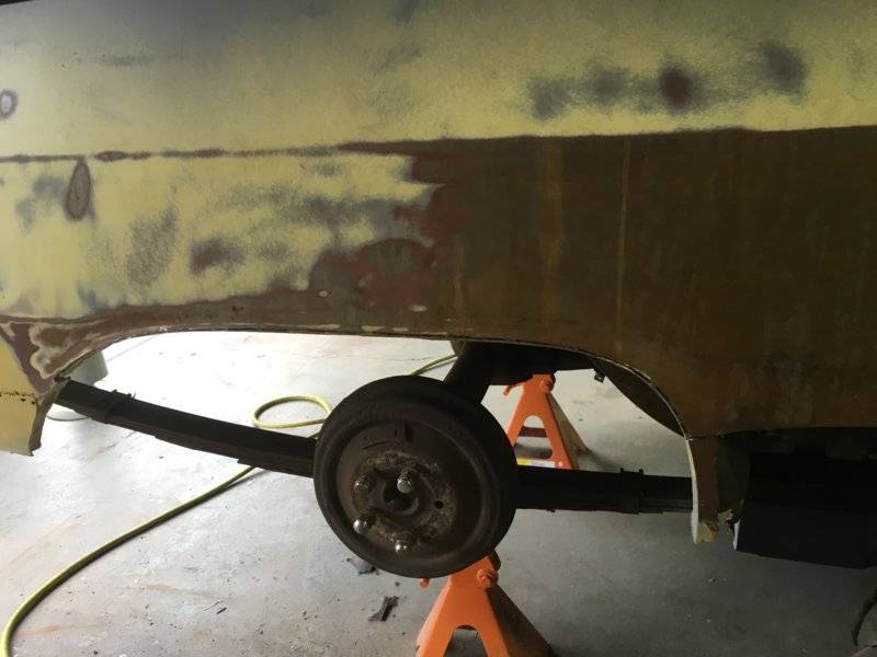

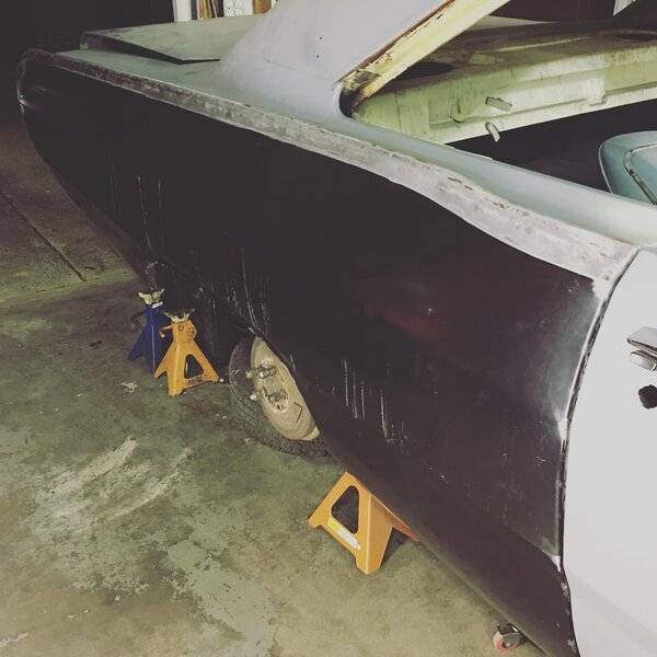

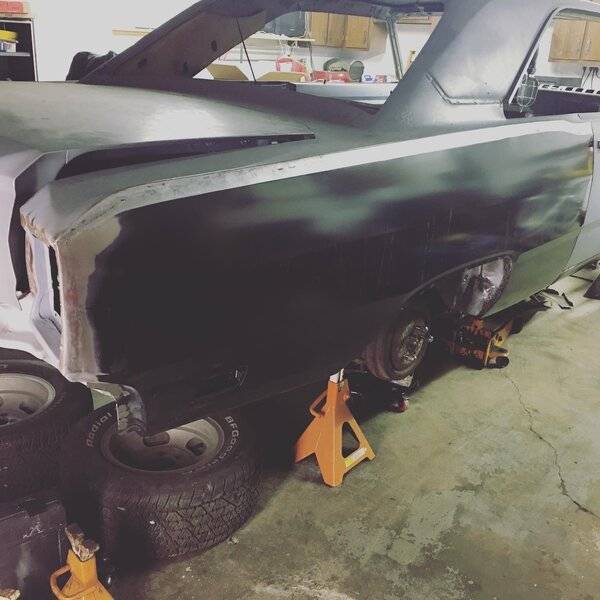

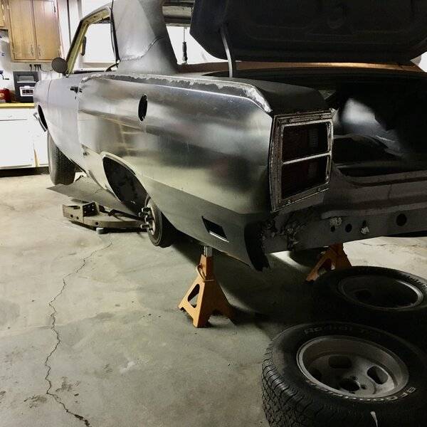

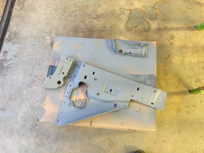

i took the doors and fenders to a company and had them blasted, the rest i did with a da and 36 grit sandpaper and a stripper wheel on a drill. small parts i blast in my harbor freight blasting cabinet.I see that you did a lot of stripping on your project. Just wondering how you did it? Blasting, paint stripper or other mechanical means? I have trunk lid, hood etc. that need to be stripped. Looks like you did a good job and was wondering how you accomplished it. I tried to PM but your inbox is full. Thanks.
