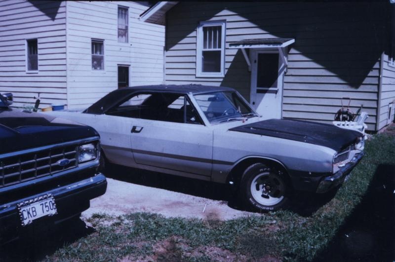

I found an old pic of my dart from when it last ran in thinking around 1995.It was pretty rough then too but it ran great .Joe dirt would have been jealous lol.

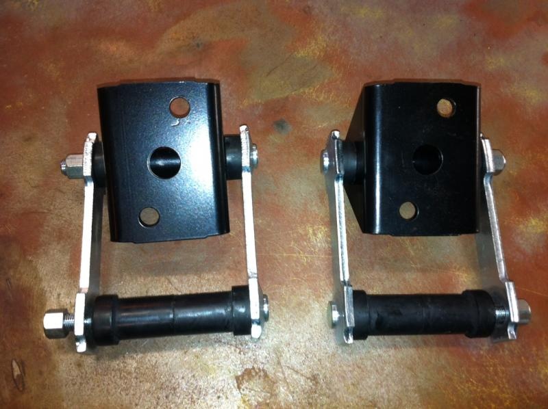

I got some new fancy parts in the mail today.I bought some nice new spring shackles and spring mounts of flee bay. Now I'll be able to bolt the rear springs to the body once I weld up the right frame mount :). Got to have the car sitting on the axles to get all the gaps to line up correctly.

always best to prefit before you weld. good job

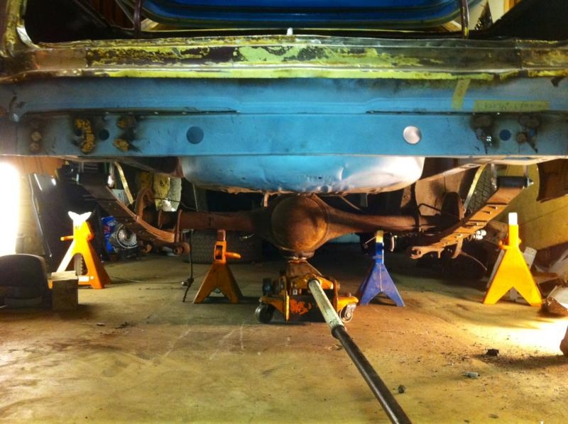

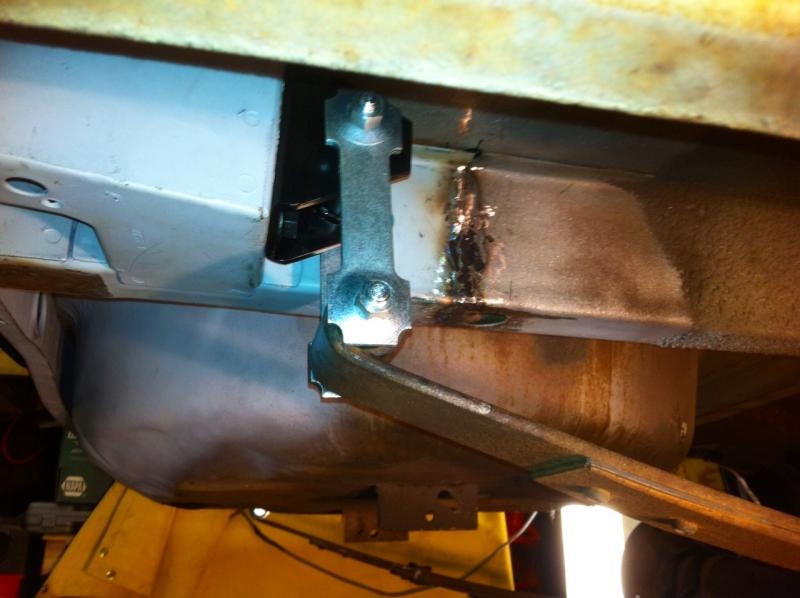

I Passed a mile stone today.I welded in the right rear frame mount and the rear cross member. My car has a solid frame for the first time in probably 20 years.I only had to replace about half of it lol. In the process of bolting up my spring shackles i broke the drivers side spring inside the front spring hanger. i guess i need new springs sooner than later . I got it sitting on its axles now. Time to replace the trunk pan and drop offs.

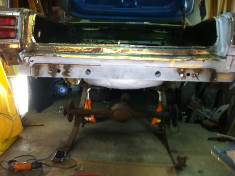

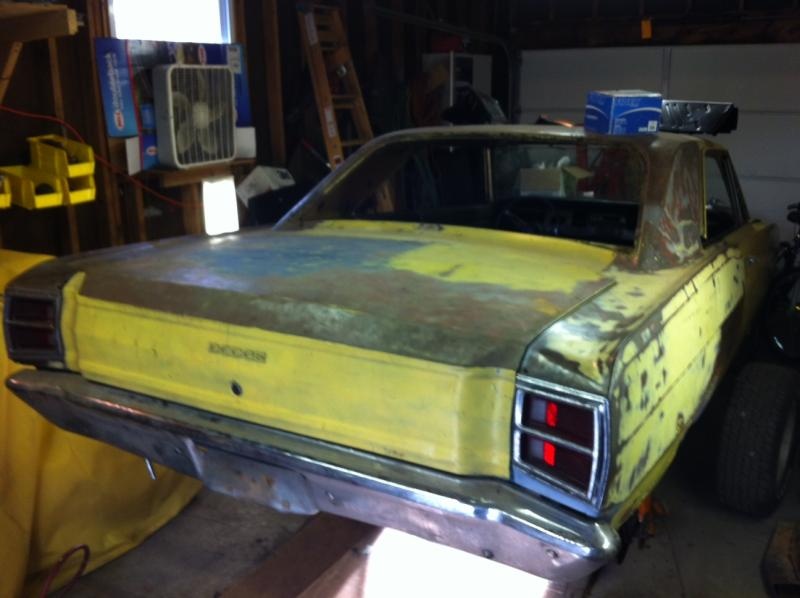

that time of year again to work on the dart lol. started trying to get the donor tail panel to fit the new trunk pan. the dart was hit in the rear at some point in its past life. i pre pulled it out when i had it on the frame rack last year. The trunk floor is about 1/2 too high to mate up with the tail panel. Im guessing when it got hit it pushed the frame up a bit . tryin to come up with a way to pull down the frame rails so it will line up. :violent1::violent1:
