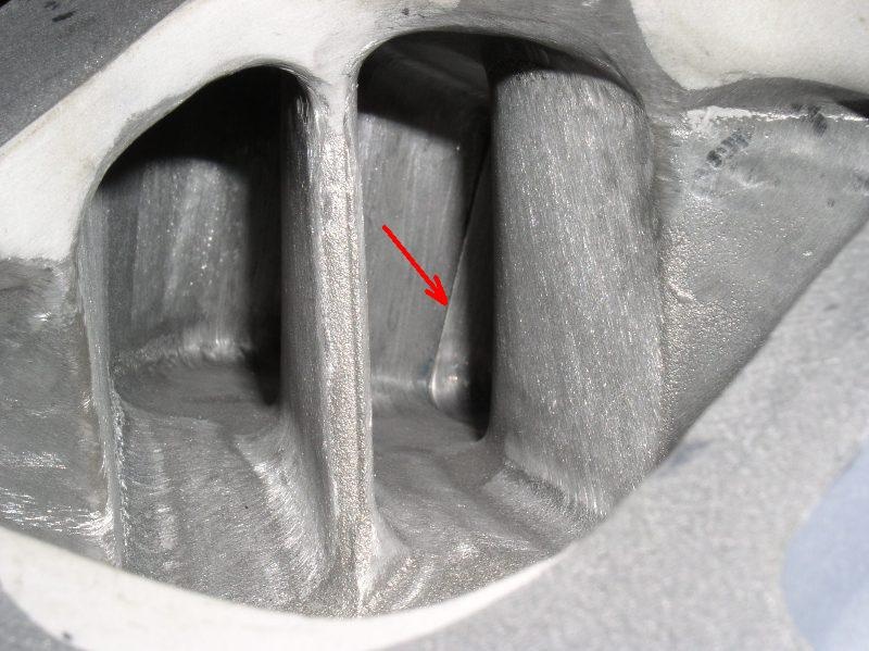

Here's the port window matched on my intake. You need the heads to do it.
The plenum is just cleaned up of burrs and stuff that can cause turbulance. And the carb hole changed to square bore from tapered bore.
Is this going to make me go $165 faster? NO... But we did it ourselves.

Looks good and those are the types of things he can do.
I see in the pick the divider wall is blended and matched for smooth transfer/flow.
good job.
My stuff lines up the same as well, I only blend the push rod side wall of the intake to match the STOCK push rod wall portion of the port entrance.
So it's still smooth and flowing, just without the speed bump/funneling.
