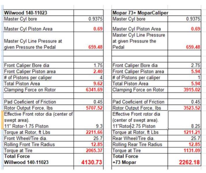

Just curious, why does this chart compare '73 OEM front brakes to Wilwood rears ? Weird comparison or did I miss something ?
Apples and Oranges...obviously fronts have more impact on braking capability.
I'm definitely NOT an engineer or rocket scientist, but is it a coincidence that all HP cars have an multi-piston brake caliper...must be a reason for it.
It compares front to fronts. The calculator I used was set up for calculating front and rears. The calculations are all the same, it just was labeled differently so I used the “rear” calculator for the wilwood specs to get a side by side comparison. I changed the labeling on most of the fields, but I guess I missed that one. It’s just a label on that field, it doesn’t change any of the calculations.
As for multi vs single piston brakes, you apparently haven’t actually read this thread very well.
Fixed, multi piston calipers are generally more efficient than single piston sliding calipers. With the single pistons some of the clamp force is lost to flex in the sliding mechanism and uneven clamping on the pads. Less of that force is lost on a fixed multi piston caliper because there’s less flex and more pistons.
But that’s in GENERAL. It doesn’t mean that every fixed multi-piston brake caliper is better than every floating single piston caliper. Which is why you still have to look at the clamp force. If it’s within 10 or 15%, you can safely assume that the fixed multi-piston caliper will actually put more force to the pads. But if the difference is much more than that, you can’t safely make that assumption anymore, you have to actually test the calipers and see what you get.
In this case, the OE calipers produce 24% MORE clamp force than that particular set of wilwoods. You can’t safely assume the wilwoods are that much more efficient. And even if you did, that would mean paying twice as much money for the same brake force.

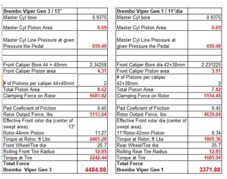

Using 72bluNblu’s Calc sheet with corrected piston count, swept area and taking into account this calc sheet doesn’t work for sequential piston diameter multi piston calipers ( had to add them together and take average)
Here it is with no Vodoo or bullshit lying applied.

Unfortunately, you both miscalculated. With the single floating caliper you have to double the normal force on the rotor, and multiply that times the surface area of the brake pads. Then the friction coefficient times the distance from the center of the caliper piston to the center of the hub to get the friction force on the rotor.

And, the "new tech" thing isn't really accurate. The old Kelsey Hayes calipers that were used on the A-bodies from '70-'72 are actually 4 piston fixed calipers, just like the Wilwoods are. The biggest drawback to them isn't their braking performance, it's the scarcity of reproduction parts available to rebuild them.

And I certainly didn't "make up" any data. I used the specifications right off of Wilwood's site, as well as the dimensions I pulled off of an extra set of the Mopar 73+ calipers that I have. Hell I even linked to the specs.
I DO understand why clamping force is a benefit. And I said in post #12 of this thread that multi-piston, fixed calipers are more efficient at transferring force at the piston into actual clamping force. They lose less of the generated force at the piston to flex and have more even pressures across the pads, both of which improve the clamping force. But, the Wilwood calipers in questions have a significant disadvantage because of their smaller pad and piston area. They generate less force at the piston than the Mopar calipers, that's just the reality of their piston area. I have NEVER argued that single piston sliding calipers are better than fixed multi-piston calipers in general. But that's not what we're talking about, we're talking about two specific calipers, and while the Mopar calipers do have a simple, less efficient design they also have a lot more piston area.
Now, neither one of us knows for sure if the actual clamping force is better for the 73+ Mopar brakes or the Wilwoods. That number can't be calculated like the force generated at the pistons, it has to be measured because you have to know how much force is being lost to flex and uneven pad pressures. No caliper will transmit 100% of the force at the pistons to the rotors. The 73+ mopar calipers would need to lose an extra 24% of the generated force at the piston though, which is a lot, to end up having less clamp force than the Wilwoods we're talking about, because that's what the Wilwoods are giving up for piston area. Is it possible the Mopar calipers are losing that much force? Sure, it's possible. But again, someone would actually have to test it in order to know that for sure.
Now, if you've tested every OEM brake system available since 1996 why don't you actually test a set of 73+ Mopar calipers against the Wilwood Dynalite's and post up the actual clamp forces? You can easily do that if you have the equipment and experience you claim to have, and personally I'd LOVE to see the testing results. Even if they prove me wrong. At least then people can make an educated choice between the 73+ mopar calipers and the Wilwoods, weighing the cost of the Wilwoods against their actual performance.
