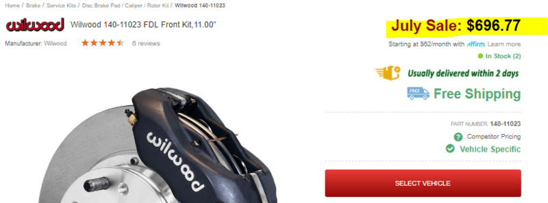

When upgrading my 10" Drums it was a short leap to Wilwood. Here's my thought process.
For me, the deal braker going factory was:
  1. having to buy spindles. If you need disk spindles, even a GREAT price for used spindles is at least $125 shipped---New off shore copies are $200 shipped
  2. The TWENTY EXTRA POUNDS PER WHEEL OF UNSPRUNG WEIGHT.{I think its ridiculous to see guys spout off about how great their thousand dollar+ suspension mods are the bees knees in one post but also swear to their dying breath that the HEAVIEST disk brake setup available is pretty much always "the best"}
FABO group think dogma says just go to get factory stuff from Dr.Diff,,ok well that's over $550. Not really a steller deal and that's for reman calipers and Chinese knuckles,,,,meh
Even if you RockAuto most of the parts and find knuckles, the core charges and shipping still winds up the same price
Ok so over $550 for 38lb PER WHEEL worth of factory bits.
I'm building my Swinger with a 3.6L pentastar for better weight distribution and 40lb hanging off each knuckle wasn't siting well, especially for $550. WFT! For $150 more I could just get 100% brand new Wilwood.
But is the $150 difference worth it?!?!

The Wilwood kits I'm seeing are definitely more expensive than what you're showing (in the 900 range), not sure if it was a short duration sale or something but I thought I checked their site around the 4th to see if they were running any specials.

- You quoted a sale price on the Wilwoods. Nice if you can get it, but you're not comparing straight across
