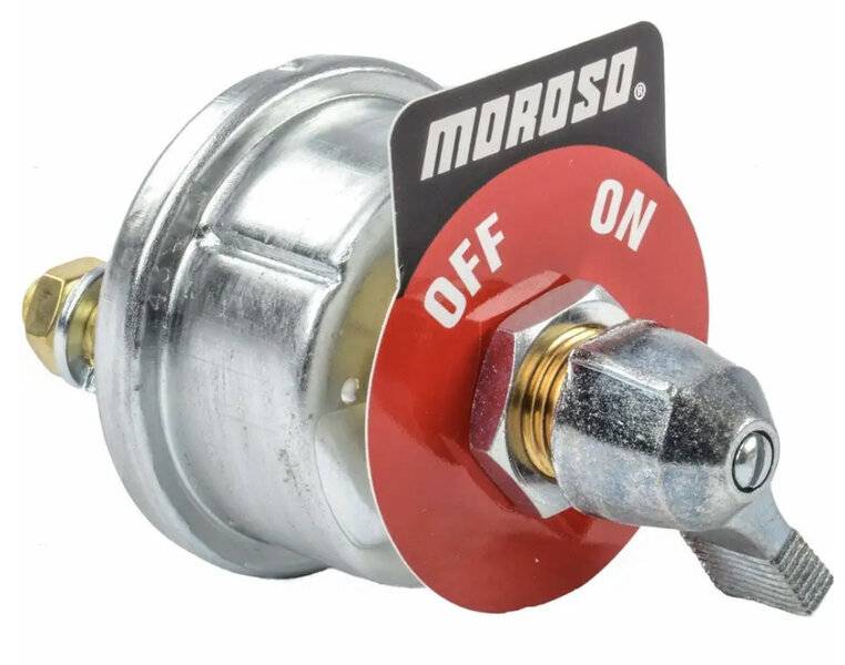

Here’s the battery disconnect switch I’m using;
Moroso 74101 Battery Disconnect Switch 84663741012 | eBay
