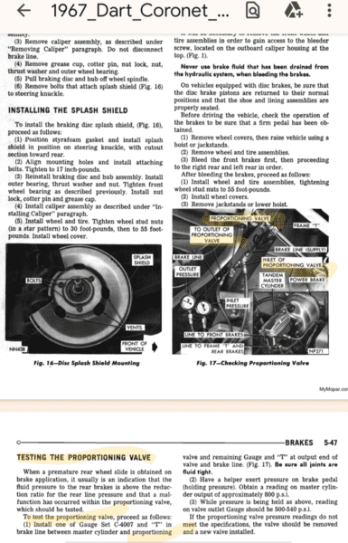

Jul 26, 2025 #2 Dana67Dart The parts you don't add don't cause you no trouble FABO Gold Member Joined Jul 16, 2017 Messages 19,275 Reaction score 16,664 Location Northern Colorado I'm loosing faith in Inline 67 hold off valve??? FSM says proportioning valve I believe the FSM over Inline, especially with the test procedure 800 in 500-540 out That's 65% reduction
