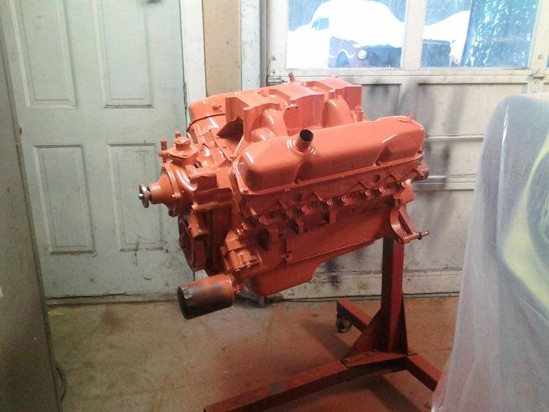

Nice example below, where I'm seeing telltale signs here that this engine has had a '$10 Spraycan-restoration' by the seller.
Clueless buyers who usually only look at paint, whether it are cars or engines, might fall for this and get taken badly;
For me cleanliness comes with tidyness and eye for detail; Prepping parts for paint right after they've been machined or worked on, then go on to another part as the engine build progresses.
I like to be able to see/confirm new head and valvecover gaskets if one claims an engine has been rebuilt. Not thick paint and drips on everything and other attempts of hiding a possible slappy build job.
I simply don't trust showpoodle engines.

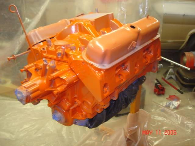

i like to paint them all assembled.. just looks right to me... nothing looks like a short cut to me:)

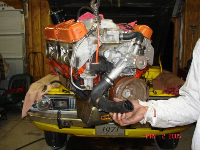

now this looks like short cuts were taken.. ugly with that bare alumn and all...

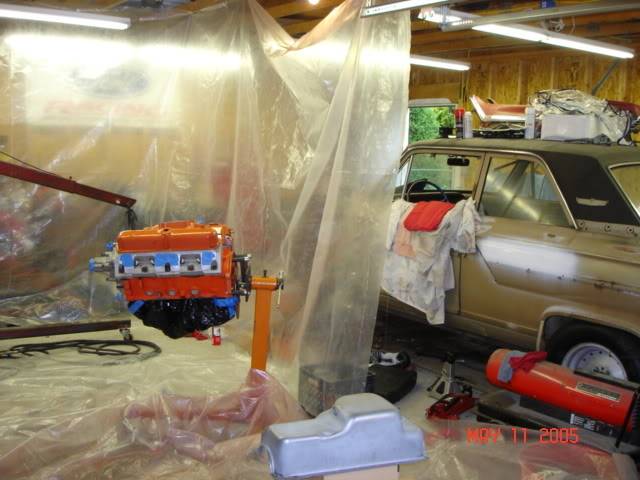

cleaned up and ready to paint the right way..:) that orange on the valve covers and intake are mopar performance street hemi orange.. way off. its way too pale to be correct. most don't notice though so its not a big deal i guess..
epoxy primer on...
high solids urathane on..
ready to go in...
on its way back together...

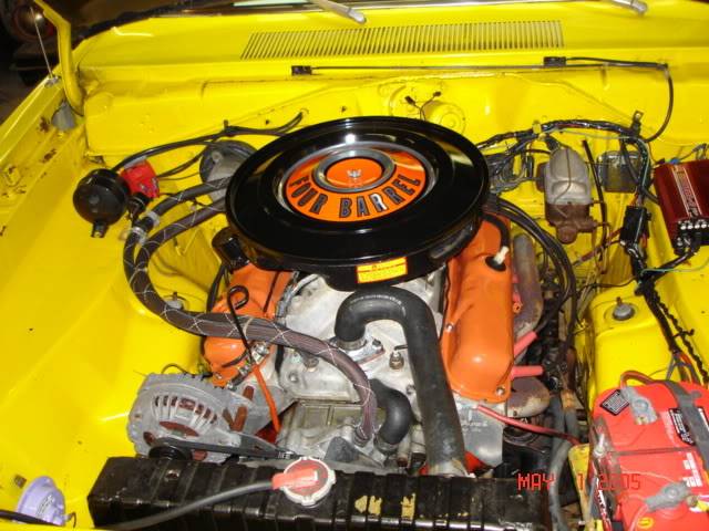

here is how we did the motor that just went in to jamies dart...
cleaned it up...
in epoxy prime..
in high solids urathane paint..
in and almost ready to go...:)
On the first engine you posted, you missed a few bolts on the intake, valvecovers and waterpump. You also forgot to douse the intake gasket and breather grommet with paint. ;)
Too bad about the thermostat housing though...
Sorry, too much detailing going on here, I'm trusting this engine... :D
intake bolts were stainless and stayed that way.. wp bolts were painted afterwards as needed, valve cover bolts were chrome or stainless and stayed that way.. don't like the grommets or battery cable painted so i chose not to. can only do so much when taking up space in a friends garage.. some things had to wait till i got home.. :)

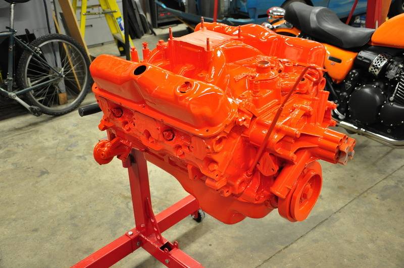

Now, I will agree this engine looks like ****. I would probably walk away from this one if it were up for sale. You can Def tell it was a quick cover up. BUT, there is an obvious difference vs this and someone who took the time to do it right. I don't have big paint drips on mine ! I also have pictures from start to finish on all my builds.
