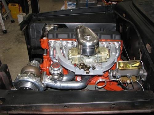

OK, it looked like a pretty decent sized intercooler so 500 HP makes sense. That is an excellent addition (based on running one engine with and without). What is the turbo? And max boost? Or do you have a link to general info on this setup? I've just run/raced 1 turbo setup (2.6L Mitsubishi) so am just a student (who perhaps has passed the first semester of "good ole Turbo U."); am still gathering knowledge.

The turbo is a 65mm Turbonetics and is a twin to another, identical turbo on my friend's '87 Buick GN. His car runs in the tens and the engine size s almost identical, so it should work.
I built this setup as a clone of the engines in Tom Wolfe's car and Ryan Peterson's; both are over 500hp. That doesn't mean MINE will make that kind of power, but the parts are all the same.
They both run 25+ pounds of boost; I am starting out with only ten... to give me a chance to get the chasssis sorted out. Then, I will up the boost, if I haven't blown it up by then...:oops:
I also have a Snowperformance chemical intercooler, which I think will help keep things together.:prayer::prayer::prayer:
Detonation is the enemy... and I am aware of that, and do everything in my power to avoid it...
Pray for me... LOL!
Do you have a link to general info on this setup?.
No, but here is the crux...Block was bored .065" and fitted with Wiseco forged pistons, .167" down in the hole, which gives 9:1 CR with* a stock, un-milled head and an*un-modified combustion chamber.* Steel head gasket, .022"-thick...* ARP 220,000psi (special-order, head studs, K-1, 198*rods that use ARP rod bolts, forged crank turned .010"/.010" and balanced.
Head is ported (n0t milled) CR is 9:1, measured; is fitted with oversize valves (1.75"/1.5") and utilizes a homemade header, and an AussieSpeed long-runner intake manifold with a Holley 650cfm double-pumper carb that has a boost-referenced power valve and other blow-thru modifications.
Cam is a Bulllet (brand) flat tappet, solid-lifter regrind with .484" gross lift with stock, 1.5:1 rocker arms; 210/210-degrees of duration @ .050"-lift and has 115-degree lobe separation.* The valve springs are new, 340 springs to which a small (weak) inner spring has been added.* They supply 132-pounds on the seat and 310 open.* Rocker arms and pushrods are stock (1.5 arms.)
The oil pump is stock, but a Moroso "Accusump" will be used in service (ads 3 quarts to the system.)*
Red line 5,500 rpm
Ignition is by means of a stock, electronic "Lean-Burn" Mopar distributor with no vacuum canister, and no centrifugal advance mechanism of any kind (the distributor provides NO advance of any kind.)* Timing is set at 18 crankshaft*degrees* and stays there.* No "curve." Don’t expect ANY reasonable gas mileage out of this setup; it’s strictly for racing.
An MSD 6-AL II module is used with an MSD Blaster II coil.
As I said: this is a race car; that "tune" on the distributor*might not work well on the street.
Oil pan was deepened 2.5" (sump only) and baffles added to preclude starvation under hard deceleration.* It has a modified pickup for accommodating the deeper pan.
A SnowPerformance Stage I Boost Cooler alcohol/water injector was added to battle the tendency to detonate under boost.* The thing starts spraying at 8 pounds of boost; #1 nozzle (.100"). A Spearco, front-mounted*intercooler is used to help cool the charge.
The turbo is a 65mm Turbonetics (T-4, I THINK; not sure.)
An appropriate size external waste gate was fitted to the header.
The transmission is a “built” 1973 Slant 6 904 with a 2.74 first gear and a reverse-pattern, full-manual, Turbo-Action valve body.
The converter is a 3,500rpm-stall, Hughes
7290 U-Joints are attached to large-size yokes on both ends of the 3"-diameter driveshaft, while the axles are Yukon high-strength units with Green bearings.
CalTrac traction bars, 50-50 shocks and weld-in sub-frame connectors are used with 90-10 front shocks and aftermarket disk brakes in front.
A six-point roll bar was welded in and a driveshaft loop added.
The fuel system consists of a* Summit 8-gallon fuel cell, two inline filters (one before and one after the Walbro GSL392 electric pump,) and an Aeromotive boost-referenced fuel-pressure regulator, set at 6psi.
The car weighs 2,680 pounds without a driver.* It has a fiberglass hood, battery in the trunk, no front bumper, no rear seat and light-weight front buckets.** A Turbo-Action "Cheetah" floor shifter is used.
It has an electrically-driven fan and water pump.
Slicks are the biggest I could get to fit (9"-wide, 26"-tall on 8"-wide rims.)* They are Hoosiers.
Coil-spring accessory "helper springs" raise the rear for (needed) added tire clearance.
If my engine can produce within 100 horsepower of what Tom's and Ryan's do, I'll be very happy.* This is my first attempt at a slant six and a first-ever turbo motor, so I am just learning.
My car is just getting finished and ready for some shakedown runs.* Wish me luck; I’m gonna need it!!!*
