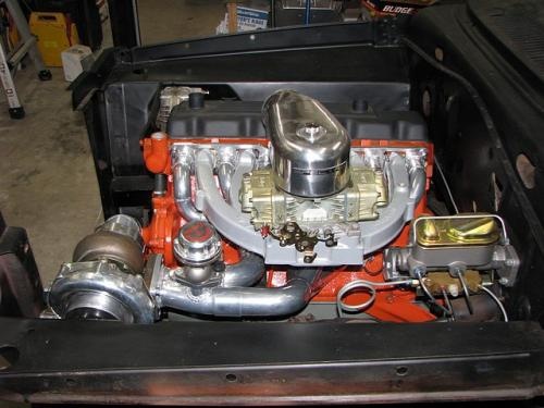

Here is a picture of the aforementioned "PISHTA" J pipe.... Makes it possible to add a moderate performance turbo without welding on the exhaust manifold... so, cracking is usually avoided. Exhaust manifolds on slant sixes are prone to cracking. especially in cases where they have experienced the heat of welding...
That J-pipe avoids your having to build one of these....

Is there anything supporting the turbo weight on that J pipe besides the pipe and the exhaust manifold? Ans is that a particular intercooler, Bill, or just a custom one?
I can't answer the question about the support, but it varies with the user, I think. There are people on FABO who have built a support for the turbo, but I don't think all of them have... It's probably pretty easy to make one... your choice.
My intercooler is a Spearco, off-the-shelf unit; supposed to be good for 550 hp... way more than I am likely ever to need...
