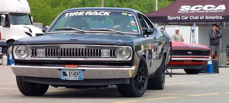

Is this the same guy?
By the license plate, it looks like it.
Nice looking car.
Lots of people confuse our cars. Brian's car is a 71, mine's a 70. The easiest way to differentiate is I have black bumpers and he has chrome.
Funny, I hadn't noticed the bumper being chrome on his. I always look for the opening/slot you added to yours.
