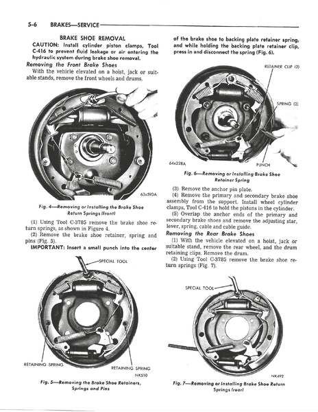

Alrighty then, I'll disassemble everything and start over. I've done a ton of brakes over the years, it's gotta be something simple I'm doing/not doing. One thing that does puzzle me though...on this car, the shoes are held to the backing plate with cone shaped springs that go through the shoe. So why was this lone stud, obviously from a different car, in the drum? When I pulled the drum off and disassembled the brakes, this was on the floor with the springs and other parts. Here's a pic of the drum and brake assembly.
First I`ve seen of that. You might have the wrong kit, for shoe retension . look at the pics above...
I actually had ordered a set of those hold down springs from Rock. You take a small screwdriver or punch and push inside the spring to hook it onto a clip on the backing plate.
There are two different shoe retention set ups depending on the year, there’s only 1 hardware kit that’s widely available now and it’s for the later style.
I don’t know all the exact details since I don’t mess with rebuilding front drums at all and just convert to disks. From what I understand the later hardware kit does work but it has different parts especially for those shoe retention pins. There’s a thread here somewhere on it.
I kinda doubt that’s your issue, but it’s probably why you have hardware you don’t recognize.
