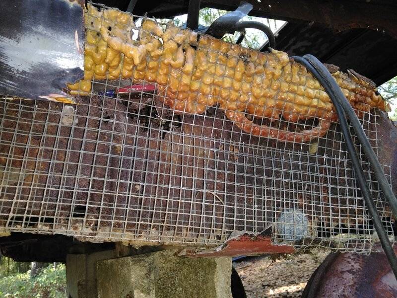

Sheet metal removed looking up into the trunk, expandable foam with a screwdriver, rope and hardware cloth reinforcement. :rofl:
