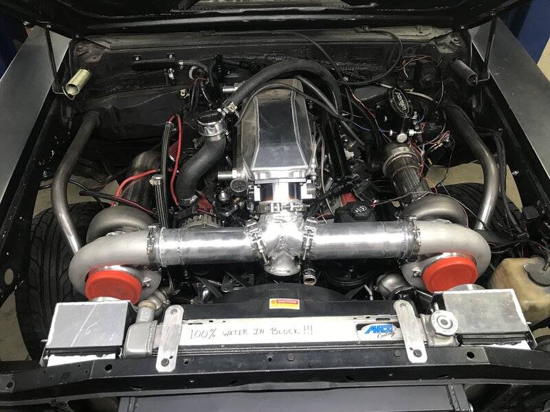

LSX 454? That’s about 2000hp worth of turbo. How’s it run?
I just delivered it to him yesterday. I didn’t start it or tune it. Lots to do before it’s ready to run. It’ll be on E85 for Sick Summer so we’ll see. Goal for summer is 8.50’s, eventually it’ll come back to me for a 25.3 upgrade on the 8.50 cage I installed (hence the floor bars) and he’ll shoot for 7s.

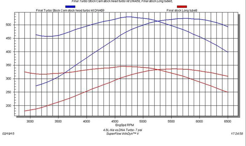

Also attaching a stock 4.8 with gt45 dyno where they’re already seeing 450 ft/lbs worth of boost at 3100rpm. This does not look laggy to me at all, but again, personal opinion.
