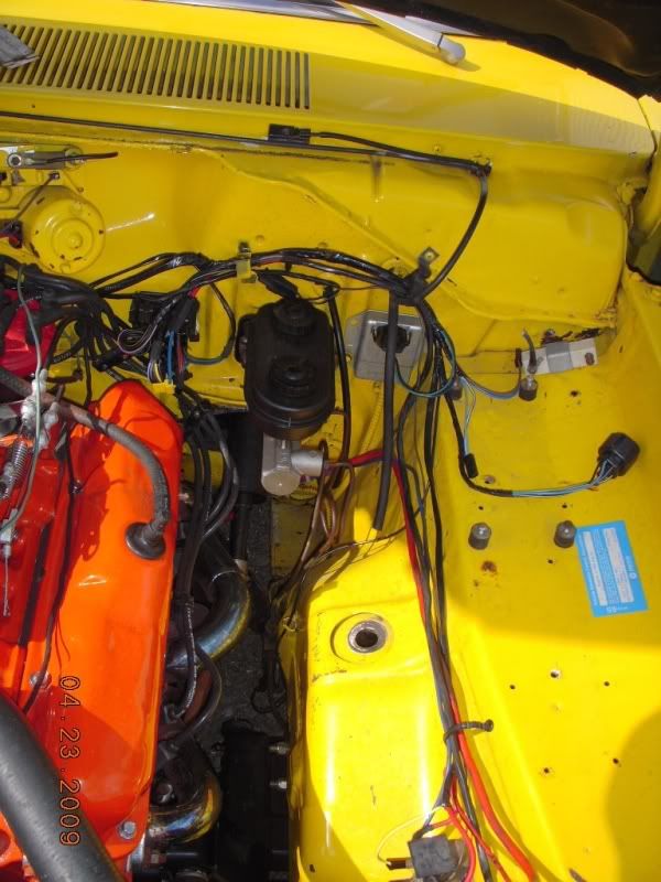

hey guys, could you please post some pics of where your ecu and voltage regulators are mounted. thanks a million i sure appreciate it! car is a slant six now going to be a small block....
I asjed the same question about the ecu but no replies. I did decide to place it on the left inner fender. The hood may have hit it if against the cowl. Too much water there too.

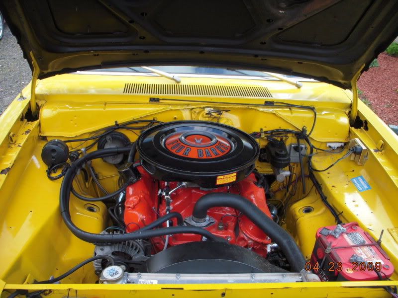

I put my regulator where the original was. Used one original bolt hole and drilled one bolt hole. A 3/8 long spacer required at that hole.
