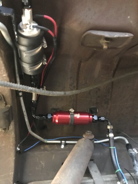

Wiring is not my strong suit but 14 gauge wire most likely isn't what you want to use. I used a relay and 10 gauge. Take a quick measurement for the distance from the relay to the pump and determine what gauge wire you should be running. Mine is a Carter pump in a short bed truck.
Put the pump where it belongs. In the tank.No more troubles.
I agree 100% that's the best place for it, but millions of vahicles came with frame rail mounted pumps and worked fine. The key is finding the right pump and giving it good mounting location that's gravity fed from the tank. But I know you know all that.

You also need to run the pump from a relay.
As RRR said, the pump needs to be mounted in the rear as close to the tank as possible.
Use a relay to run the pump. It’s so important I said it twice.
It's powered by switched 12 volt.
Are you powering it through a relay that's triggered by switched 12V? If not, that could be contributing to the problem.

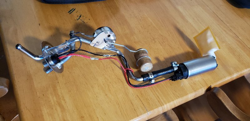

It's relatively easy to install the pump inside the fuel tank, but you will also need a bypass regulator with a return line to the tank. Being submerged in the fuel helps keep pumps cooler. I used this method along with a surge tank on my '68 Barracuda convertible.
On my '70 'Cuda, I mounted the pump is mounted externally to the tank, but it was designed to be mounted either in or out. It was not cheap, but it is one of the few pumps rated to be able to lift fuel rather than having to be mounted below the tank.
