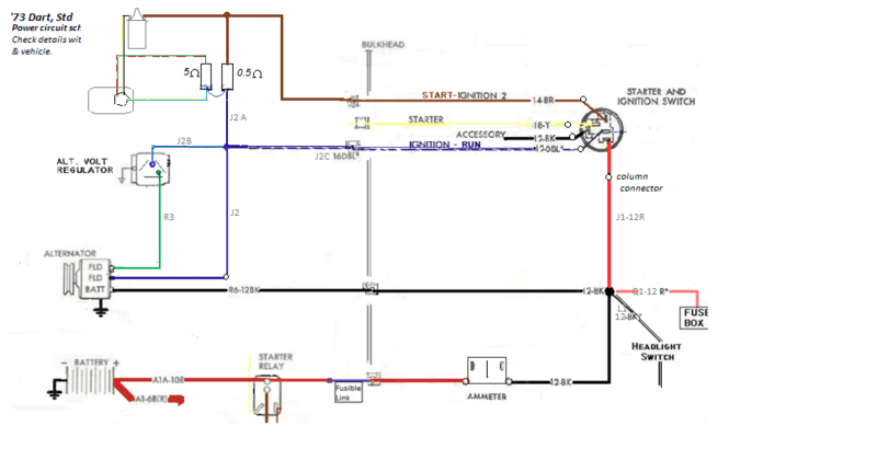

On that page is this simplified diagram of main power distribution
Notice the "welded splice" in the large black ammeter wire. This is under the dash, not far from the ammeter, wrapped up in the harness. That splice branches off and receives power from the alternator, and feeds power to the headlights, the fuse panel "hot" buss, and the ignition switch main feed. Some years, one or two other feeds.
Since you have all this apart, I would carefully take the ammeter apart, "if you can solder" and silver solder the studs to the shunt. You will need to get this all clean and use proper flux. Some of us bypass the ammeter and convert to a voltmeter
Damn near every electron in that car flows thru the ammeter. Bypass the p.o.s. ammeter by bolting the connectors to the same stud and bypass the bulkhead connector (search the site) or risk burning your car down.
