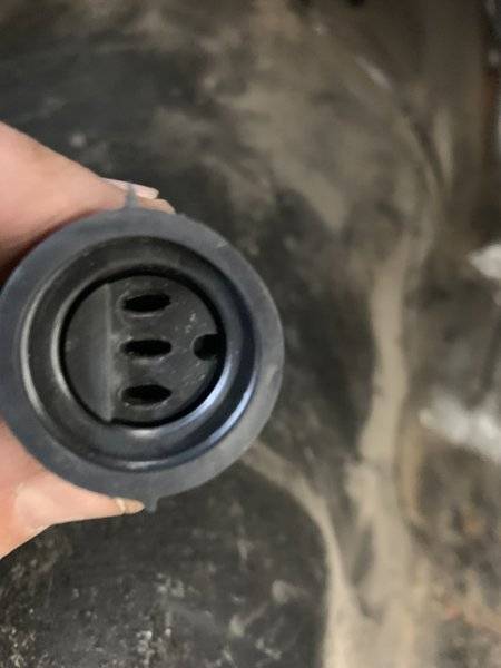

When I ground the center wire of the NSS connector after removing it from the transmission, I can get cranking. I have a new NSS coming from napa in a couple hours. In the meanwhile, Is it possible that there is an open ground in the seatbelt wiring that could prevent cranking? The seatbelts are not installed.
Check wire continuity from NSS to starter relay. The connector at the NSS can be finicky.
Maybe make a jump wire to test from NSS to relay.
I grounded the center wire of this connector while it was plugged into the starter relay and got cranking. I “assume” that means the wire is good. Brand new connector
Then it's either bad NSS or out of adjustment, or problem in the "rooster comb" internally
Make certain switch has the correct gasket (I can't help you there) and is properly tightened
If you are shifting by hand it might not be engaged. Try N instead. Your mention of the seat belt deal interupts the path of the yellow wire on the road to the starter relay, but that only affects 74 cars, and they have the infamouns "reset" box under the hood
It was the NNS. The connector that touches the rooster comb was not extended. Problem solved. Thanks for the help.
