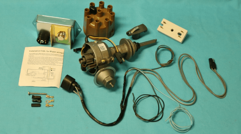

I got a conversion kit from laysons restoration. The car has a 2 spade Ballast resistor but the kit comes with a four spade ballast resistor. Do I need to use the 4 pin? And if so how does this change the set up?
From the Layson's site, their TM90426, which is the small block V-8 kit, is shown in their following image:
The six cylinder and big block V-8s are similar, although the latter is not pictured on their site. The image shows an instruction sheet.
I have not seen or used this kit, but the instructions likely specify using your two terminal ballast resistor. The original points system resistor was 0.5 ohms which is usable, but anything between 0.5 ohms and 1.25 ohms works. With the two terminal resistor, the green with red tracer wire is not used, nor are the extra female spade terminals, plus your stock ballast resistor wiring remains unchanged.
The four terminal resistor, the female spade terminals, and use of the green with red tracer wire is optional. Using it will allow the use of older, real 5-pin electronic control units (ECUs).
The kit is provided with a 4-pin ECU according to their site. The pictured ECU has five pins, but the fifth pin is likely a "dummy", for looks only.

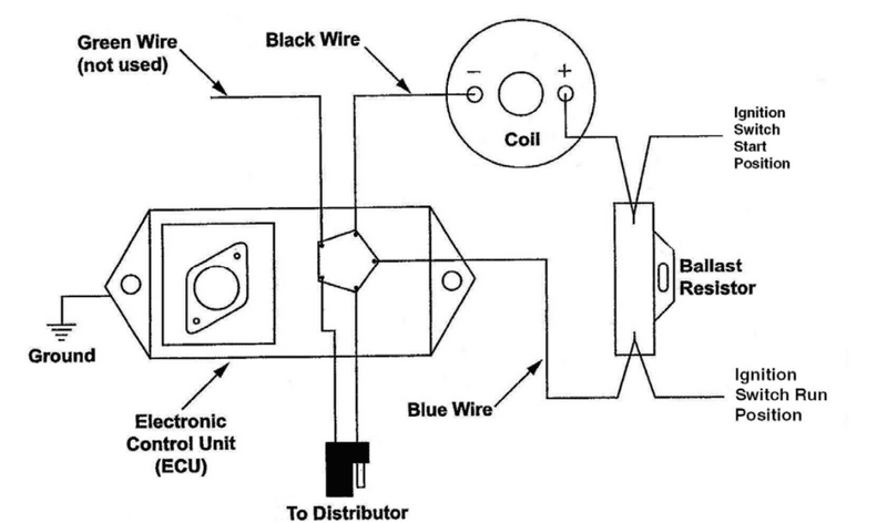

Wire the system using the following diagram, or what their instruction sheet specifies:
NOTE: the blue and black wires shown here may have a yellow tracer, but are the same otherwise.
If by chance, a real 5-pin ECU is in the kit, the 4-pin ballast resistor and extra wiring will be required. It is unlikely they are using real 5-pin ECUs. In some of the description, they do state using Borg Warner 4-pin ECUs, but their site and information is somewhat limited.

They have a 5 pin pictured.
Thank you for the information! The A body folks are always solid! My kit did not come with instructions, there's no brand name and the QR code thats on the distributor goes to a site that no longer exists. It's for a 383
I would bet money that module is actually a 4 pin. Simple connect it up temporarily with the 4 pin ballast, and unplug the wire leading direct to the module from the ballast. If it quits, the module is a 5 pin

The wire legend at top right on post three is WRONG. IT does NOT go to the "start" circuit. It goes to the original brown ballas bypass. In face so far as the ballas on the coil side, that wiring is basically unchanged from points to electronic.
IGN 2 has power when the key is in the "Start Position"
IGN 1 has power when the key is in the "Run Position"

The photo Vaanth posted from Layson's website shows what looks to be a ECU with a fake transistor and yet they are supplying a compensating (5 ohm) resistor) along with the ballast resistor. And no instructions? I don't trust the people who put this kit together. Bet the ballast is far more than .6 ohms. And we have no idea what the distributor has in it, as far as advance curve.

If you really want to switch to an ECU and magnetic pickup distributor, my suggestion is to get a piggyback connector and place it on the ballast resistor. Then attach the ECU power lead (usually light blue, always from the top of the pentagon connector) to the piggypack using a 1/4 push-on terminal.

When I was taking photos I realized I had the ECU powered by the output of the ballast resister rather that the input to the ballast.
It ran fine for 100 miles yesterday that way! Go figure!
