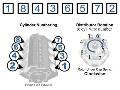

Are you sure you have the firing order right?It,s definetly mis-firing by the sounds/shake of it.
Edit:After stopping the vid and looking at the top of your cap(plug wires)I,m going with wrong firing order.JMO

I always thought this would help people that were new to it, so I finally did it.
Of course it's only acurate if the rotor points at this plug tower on TDC.
This is what I did to get the timing, I've installed the oil pump drive shaft so the slot in the top of it is pointing at drivers side front manifold bolt when cylinder no.1 is at tdc.
I really like this, should help him a lot.
Its real hard to tell in the video but I'm with pettybludart. don't thing its wire right.
It looks to me that 6 and 8 are together in the fire order, and that's not right.
