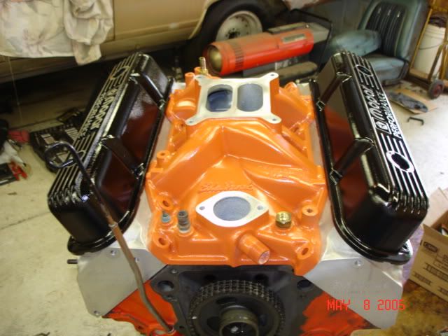

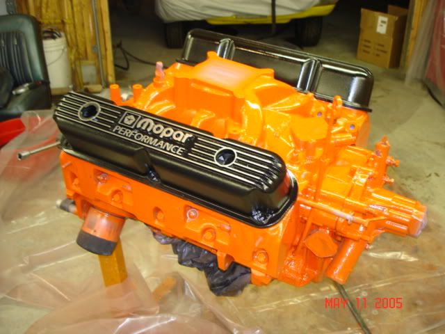

the intake and valve covers in this pic is MP street hemi orange.. its no where neat the correct color. i hear the resto street hemi orange is a lot closer though..
in primer...
painted..
info off the paint can..
