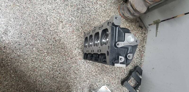

It seems there has been a lot of confusion in the last while about the "EQ" smallblock replacement magnum heads. The GOOD castings, which are no longer available are quite easily distinguishable from the later chinese versions, I'll show a few pictures to help anyone out that might be looking at a used set, or a nos set of castings and not sure the difference. There is a SIGNIFICANT difference in out of the box capability also. This first pic is the good castings, although these are LA intake pattern
This is the typical currently available Chinese head, regardless of who you buy them from, they appear to be the same thing as the jegs,speedmaster,and house brand heads. Very different look, especially at the accessory mounting points. Also come with a horrendous valve job, and would take significant portwork to even come close to the earlier "EQs"

If you have them available, post side by side? The pictures are showing opposite ends.
It looks like it's pretty easy to spot the machining on the ends of the heads. Good EQ heads have way more meat for machining than the Chink heads. Sorry, I have a problem with so many of our items being made in China! They are NOT our allies & almost everything we get from there is JUNK.

Both ends look the same, the difference is extremely clear. But I can definitely take a exact same angle shot if it would help.
Both ends are the same then it's obvious. Great awareness pictures as I haven't owned either replacement heads.
