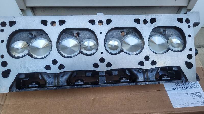

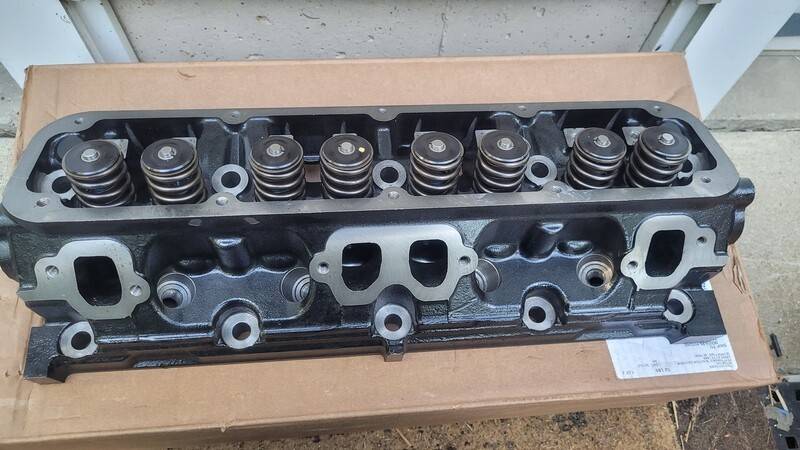

Got my heads from P.I.E. (Performance Injection Equipment).
For those that are interested....

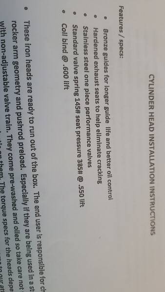

Clearly the Chinese heads, but they seemed to have done a pretty decent job with the stainless 2.02 intake valves and hardened seats, bronze guides, and minor chamber unshrouding and bowl blend. These are only their level 1 heads, but I think they'll work pretty well for my build. Supposed to flow 270.
We'll see how they work I guess.

Seems like they are a slightly diff casting or .. the chamber seem a hair different. Mayne I just forget what the others look like.

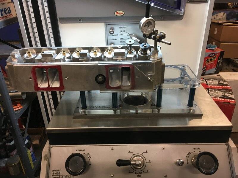

As a side note, what bench do you flow your heads on?

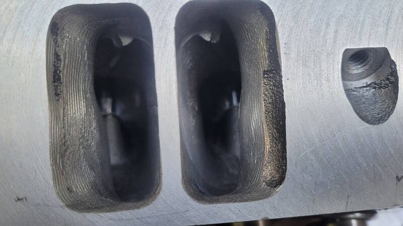

Yes I got these heads flowed as I was skeptical on the lack of workmanship. Far from what he's advertising on his website for flow numbers. The exhaust ports are not even touched. Peaks at 150cfm at .400". Intake side peaks at 250cfm at .450" but then gets so turbulent the flow just takes a nose dive to 230cfm at .500".
I'll never deal with PIE again!
When ported properly they will flow the same. The difference was the smoothness of the actual casting and the better exhaust port alignment out of the box. Those items can be addressed with good porting.

NONE of this surprises me. The port is just too small and too fast for the shortside. Even getting a REAL EQ head to flow above .500" is a challenge--these Chinese castings are worse. The good news is 250 cfm @ .450" CAN make a lot of power--like 2.06 hp/cfm if you have a semi-serious shortblock under them. The Magnum head works-you will like. J.Rob

Guys the easy way to tell the difference is the NZ EQ's do not have a core plug in the end of the head but the chinese ones do.
The quickest way to tell them apart is the China brand has a Freeze plug in the end just like the factory.
True NZ EQ's do not!
EQ-CH318A is for the LA intakes and the EQ-CH318B is for the Magnum intake.
You beat me to the punch. I actually went out to the shop to look at a NZ EQ to make certain before I posted as my mind aint what it used to be.
