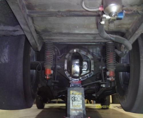

everyone talks about no room? here is my car however it does have a fuel cell in it. this is 3-1/2" all the way to the bumper with hooker Aerochamber muffs.
Looks really close around that drive shaft, how much clearance do you have there?
Well LOL the fact that the big fat gas tank isn't there sorta solves the problem, no?
I like that, but will have to see how loud (BAD) mine is going to be. anyone want a new tank for a 68 barracuda ? lol-bob
Not a whole lot of options when you have a mini tub, stock gas tank and 325-50-15" tires. I might of had enough room to run a 2 1/2" over the axle, but it would of still required exiting between the frame rails and springs. Not a good idea!
