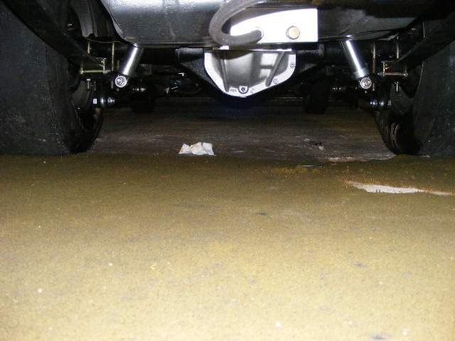

Here,s a pic of the Dana housing I bought from BEAR,S Performance(Ontario,Canada)for $485.I had to have ends welded on,then peiced it together.I,m sure you can do the same for an 8 3/4 from Strange or Moser Eng.you can also buy complete,but will cost you.Good Luck.
