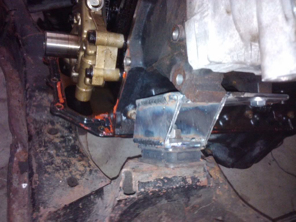

Hey guys I'm on a tight a$$ budget and I need to fab up my own mounts. I will be using the stock rubber isolators and doing something similar to the TTI set-up but with some added strength to the passenger side. I have enough steel to do a few set's and I was wondering if anyone would be interested in a set to help me offset the cost of the steel? $75 bucks should cover my time and the steel if you are interested and they will be in bare metal so you can paint them or powder coat them yourselves. I have enough steel to rip out 3-4 sets if you guys want them. Since I will be making them by hand they will take some time But I believe they will be as good or better then the TTI units. PM me if you are interested. I will be using 3/16 plate steel just so everyone knows and I have been a fabricator for 8 years so this wont be a junk job to get er done but they will be pretty nice I'm thinking (for hand made parts anyway)
Just so everyone knows I have a 67-72 K-member in my car and that's all I have to build these off of so I can't build early A mounts (unless these will fit) and I can't make Spool type mounts. Also Spool mounts require bushings which I don't have the money to buy so the price would be drastically higher for spool mounts and I would need a k-member to build them off of.

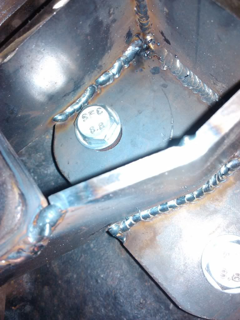

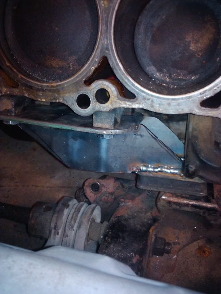

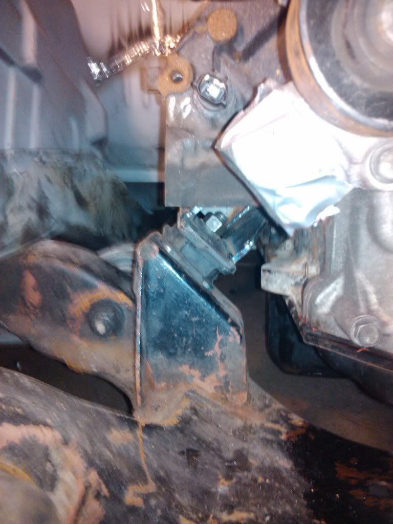

Yeah but if you already have 16 sq. ft. of 3/8" steel and a welder in the garage, why blow $130 you don't have? Plus, looking at pics of the mounts available off the shelf, these turned out way, way stronger. More material where it matters, welded on both sides of all joints, etc. Obviously people are free to buy what they can find but that's not hotrodding...
