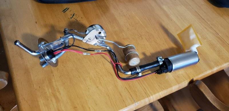

I run an in tank pump to a front mounted surge tank with an internal pump. This set-up removes any air from the system that may be sucked up when the tank is down to the last few gallons so it won't get passed to the injectors.
Both pumps are powered by the factory fuel pump relay circuit They run for about a second before cranking when the key is turned to the run position. My Start 1 and Start 2 12V are spliced together.

Make darn sure the return is large enough. It should be as large as the suction tube
i think the supply is 3/8 and return is 5/16 stock fuel line on truck.

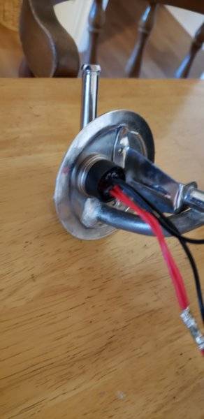

That is correct. I removed the 5/16" return tube and installed a 3/8" return tube in the sending unit using silver solder to seal it. I had to go to a welding supply store to source the real silver solder.
