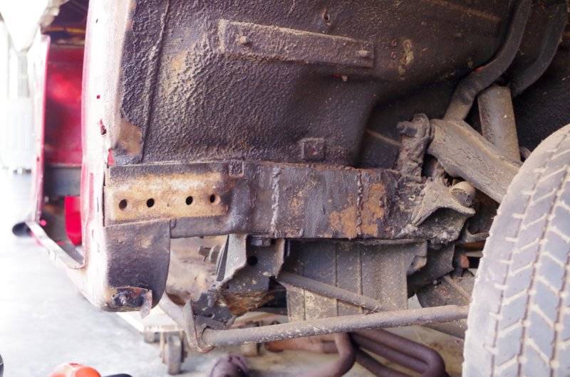

Figured out why my Cuda's front bumper was an inch lower on the drivers side.

I thought the bumper brackets were bent. Not so. Don't know about that patch, but whoever never pulled that wrinkle out to make it straight. Frame rail is junk anyway, getting replaced.
Another clue why my '69 has a '68 front end and hood.
Check the frame rail real good. If the bend is forward of the control arm mounts you can probably just splice in a front piece. Much less work that way.

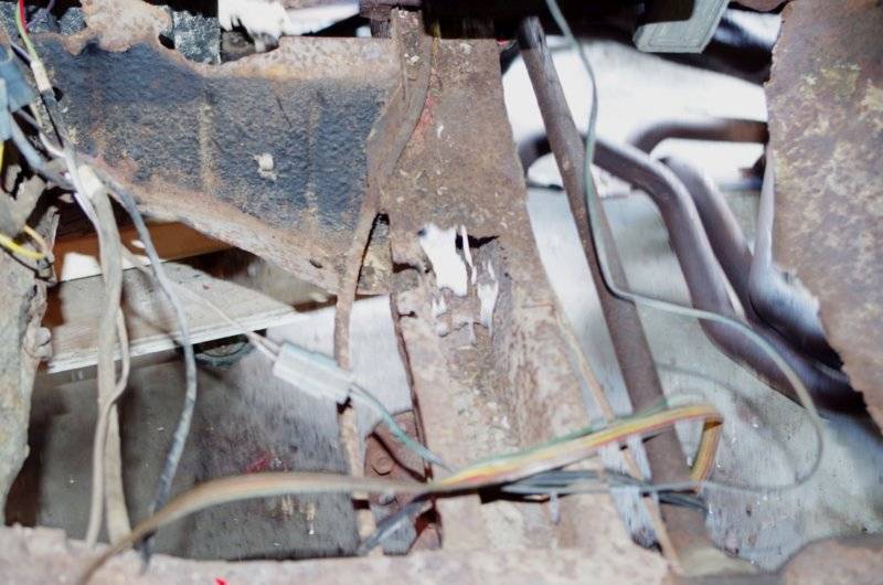

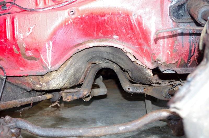

Wish it was that easy! The rail is shot, this is looking through the floor (and through the rail!). Torsion support and floor are junk. Other rail has holes in the top of the rail by the UCA mounts. Both inner fenders are junk on the bottom.
I have a complete inner tub, radiator support, rails, torsion cross member, inner fenders from a Dart that's going in as a unit.
