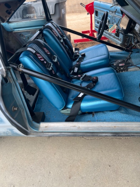

Not a whole lot of progress. Harnesses are in (photo mock up but they’re in-in now).
Figuring out the Holley dash/wide band communication has been an uphill battle but it’ll get there. List for December is getting smaller. @TT5.9mag stopped in to lend a hand as always. :thankyou:

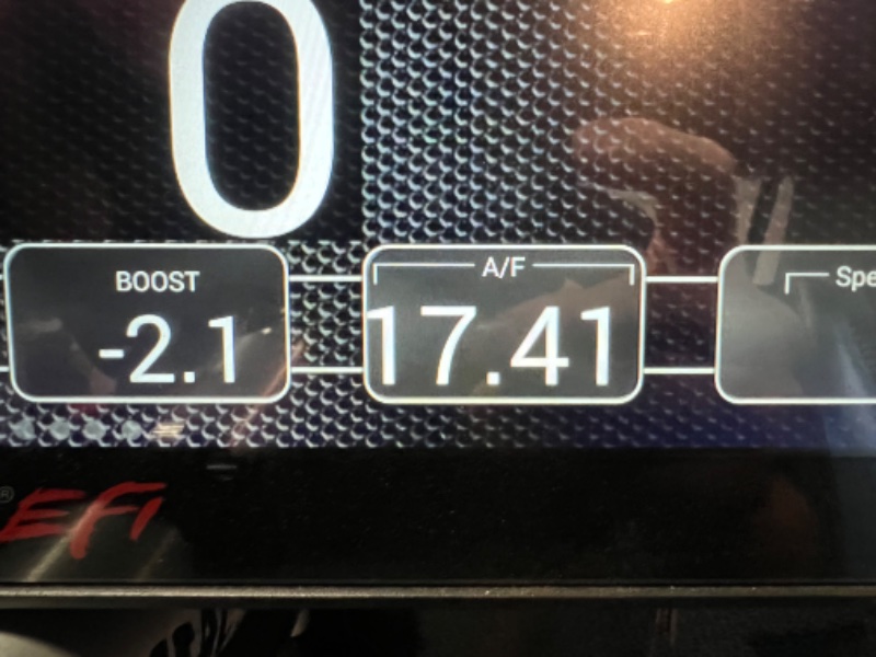

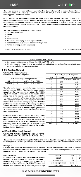

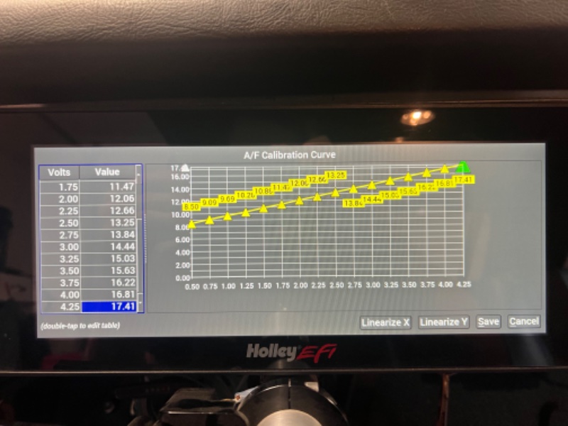

Hey @TT5.9mag i think I got this whole sensor thing dialed. Max voltage reading would put the AF at 18. Dash is one line short of the 4.5 volt reading. Can always shift the scale and lose the .5 volt reading.
Looks like you're actually about to get this sorted out. ...and right when I was about to suggest a stock slant 6 to replace all the BS. lol
So it’s much more linear than we thought. No math needed? The real test is compare it to a known good tailpipe sniffer. Westech?
We had the correct math the whole time. It’s all done for you on the scaling table.
(2.3750 * Volts) + 7.3125
If you do 2.3750 x .5 + 7.3125 you get your 8.50 on the first line. Just needed to figure out where in the dash to put the scale in.
