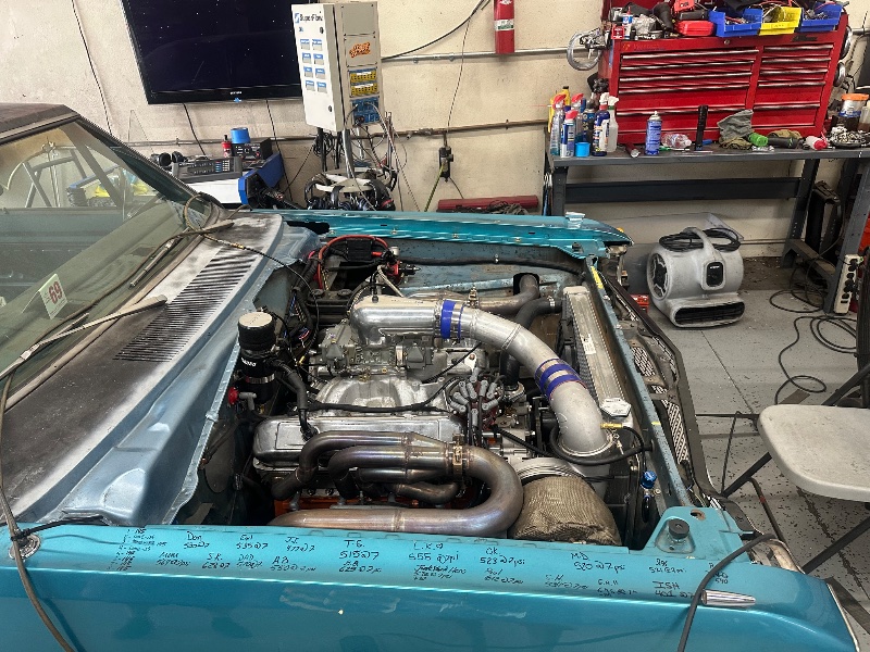

I mean, you gotta start somewhere right? Wastegate spring seems to be the correct place to do that. Does anyone ever leave it there though?

Good to have a variety of tunes per boost levels. Have a good street one then a track one.

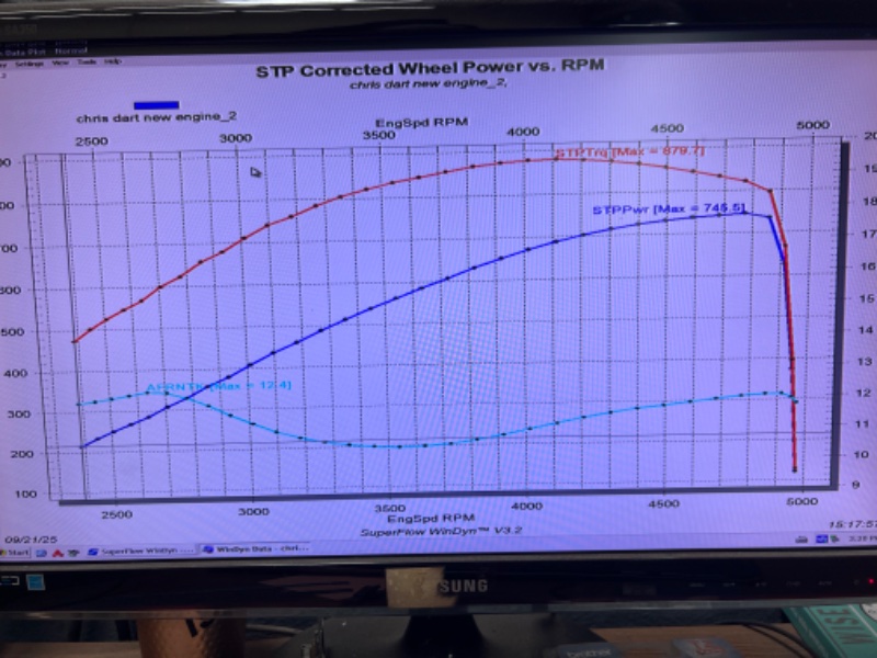

When the big number flashed on the screen all of our faces went blank, Until we saw the boost number. Then it made some sense. We definitely had no control of the turbo. We pulled the wastegate and hillbillly rebuilt it and then were able to control the boost quite a bit better. Crazy thing is Chris’ engine is making 26hp per pound boost with my dumb dumb math, at the 14 psi level. That’s a number to be happy with. @Turbo440Dart you no longer can call your garbage, garbage.
What is the rear suspension? That thing is making massive power and torque BELOW 5000rpms. It’s goin to absolutely boil those rear tires.
Split monos, sliders, Viking DA’s and assassin bars. The car isn’t mini tubbed and the springs are not moved so it’s riding on 255 ET street Rs. It’s a handful on the street to say the least
