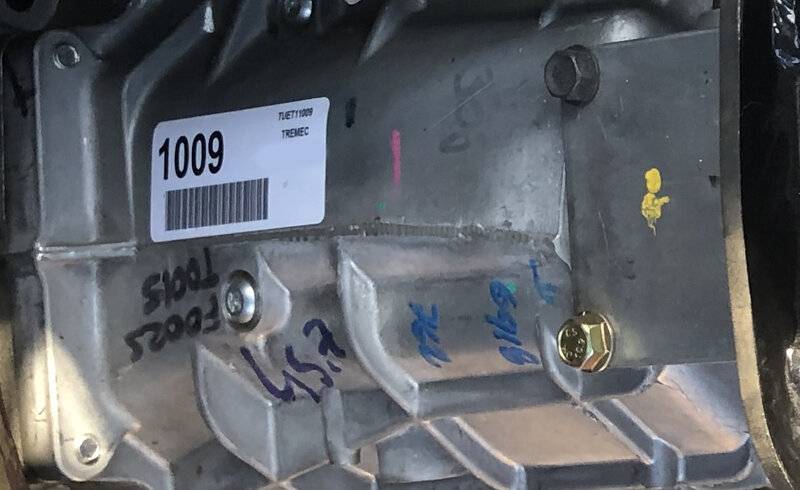

Mine has a boss there for the drain plug but its not drilled and tapped for a plug like yours. Mine is the GM close ratio T56 Magnum that Silver Sport sent with the swap kit.
That's weird. That's the same transmission I've got, TUET11009. Mine's an American Powertrain unit bought through Summit in 2016
