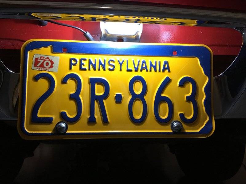

I hooked up the license plate light and bracket to the rear bumper. Got out my vintage 1970 PA license plate and installed it. I like the retro look.
The plate is a nice touch. Are you able to register the car with vintage plates in PA? In MA we can use a year of manufacture plate and sticker, of course they charge more for that privilege.
Steve, I think that you can use an original tag if you designate the car as a classic or antique. In either case, it does restrict the amount of miles that you can drive the car annually. I'll need to check with PennDOT.
