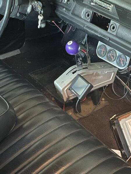

4spd consoles are much more money. I'd go with the auto.I don't have measurements but maybe fit the console over with top plate off then measure and cut top plate if it does? Stole pic off ebay
