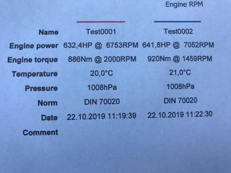

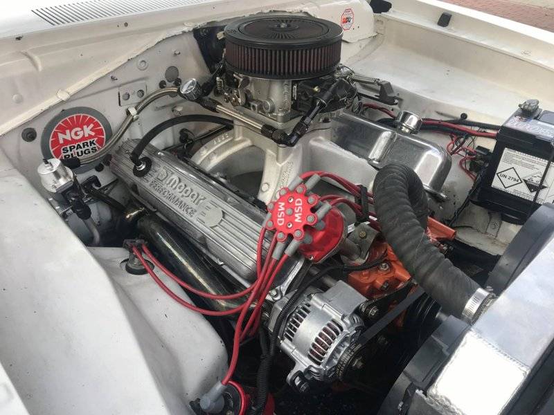

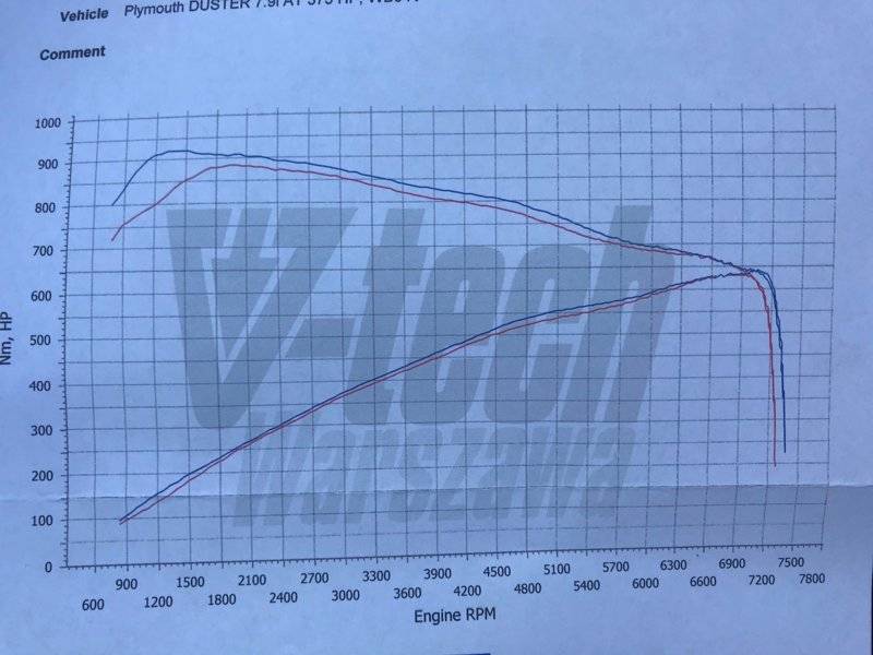

As promissed long time ago, I am posting photos from dyno run. This is from chasis dyno... 641Bhp/920Nm(678ftlb)
Car has Edelbrock Victor intake with 2" adapter and 1050 Dominator carb.
1st run was with tire spin at low rpm.
