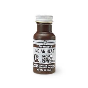

Indian Head both sides, downside is you need a 8 pound sledge to remove it next time. :toothy8:
