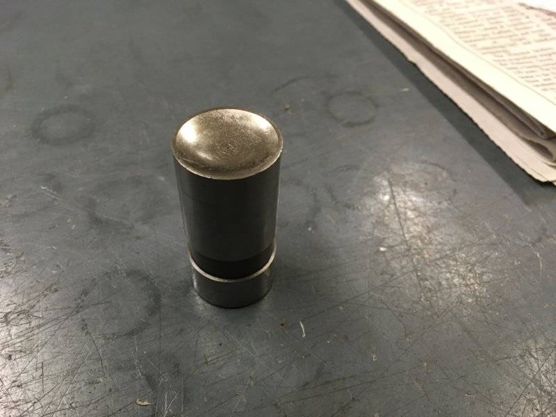

Well gang, my Comp cam is wasted. Wasn't even opening No. 1 cylinder and made the lobe almost completely round......I've ordered a new Mopar .474 purple shaft and will be diligent on the cam break-in this go round. I'll post some pics of the cam.

Problems.....
It def takes more care and the proper procedures and parts to have success with flat tappet cams these days.
Everything that came off the lobe and lifter went somewhere it shouldn’t have.
You’ll want to get as much of it as possible out of the motor.
Yours is what they “usually” look like when they’ve failed that bad, but I recently saw one that appeared to get work hardened after it had failed, and instead of that really rough torn up finish, it’s like it started polishing itself smooth.
Hyup I've seen many lifters just like that.
