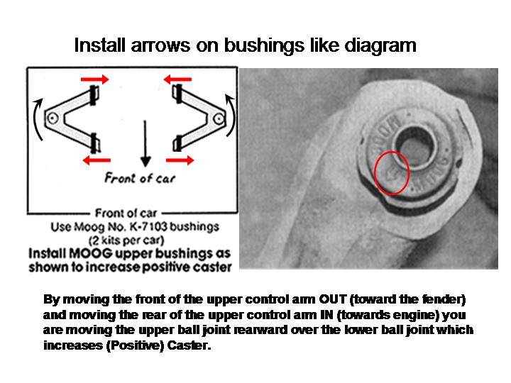

moog K7103, it's an offset bushing that enables more caster with the factory parts. i consider them to be essential when rebuilding front suspension. highly recommend them.

Not exactly true. They can be oriented many ways, depending on WHAT you're doing. But to increase caster, they should be oriented with the bolt hole in the FRONT bushings facing closest to the frame and with the holes in the REAR bushings facing closest to the ball joint. In this way, you're effectively lengthening the FRONT of the control arm and shortening the REAR, thereby increasing the caster angle. You are shifting the upper ball joint BACK towards the rear of the car. They can also be installed to increase or decrease camber as well.
If you want more caster with your K7103 bushings do not follow the instructions in the box. The included instructions are for fixing sagged out camber. Follow Rusty's recommendation above to add caster.
This seems backwards in my mind. If the the bolt hole in the front is nearer to the frame, wouldn't this be effectively shorting the Front of the control arm and if the hole in the rear is closer to the ball joint would this be lengthenging the Rear?
Nope.
Yeah. I got once I had it in my hands. Another question: I messed up the install a bit. The arrow was not 90 degrees to the control arm. My mom lives across the street from me (yes, like everybody loves Raymond) and she came over and distracted me. Anyway, can I remove the new bushing, turn it a bit and re-install it? Or are they a one use deal?
I don't know. Can you? lol You can if you're really careful. I'm not understanding "90 degrees to the control arm". Can you expound on that some?
not 90… I’m explaining bad. The arrow should be inline or parallel with the control arm but I had mine off a bit. Pointing not exactly parallel with the control arm. I got it back out. Hopefully will press back in ok. Thank you.
i get what you're laying down.
yeah you can R&R the bushing if you're careful. but if it looks sus when you get it all back together save yourself the headache and time and frustration of having to do the whole job again and just order a new one.
