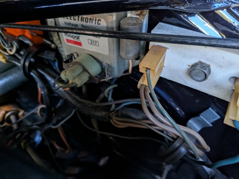

As an example, the following image shows the capacitor mounted with the voltage regulator on my 1977 Fury. The tan wire connects to the Ignition Run blue wire in the molded connector.
Another connection method at the auxiliary resistor for the power feed to the electronic control unit (ECU) is shown with the capacitor in the following image:
