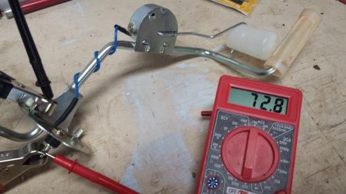

Found something interesting when i tested the sender.....oh btw I yanked the sender to test it outside of the tank. Just easier for me to literally visualize everything. Based on the bench tests, sender should be fine.
Here it is on "empty".
Even at the full mark, it showed about 15ohms.....but when i hooked it back up to the sending wire and turned on the battery, even if the float was at the "half way" mark........
Lastly, i ran a new wire from the kick panel connector directly to the sender (thinking that maybe the actual connector was faulty) as nm9stheham and 67dart273 previously suggested. Exactly the same results. Its as if the sender only starts working after the half way point. But bench tests show otherwise.
Well, it does not read as low as it should with the tank full....so that is why the guage does not go to full. Sender is not right with 34 ohms at the FULL positions. I'll give you kudos for a TON of persistence.
Well 34ohms was at the half way mark. At the full mark it read about 15. Oh and I re-measured with the meter prepped correctly. Everything read at 5v. Think I will just get a new sender and see what happens.

OK, the posts were confusing; it looked like 34 ohms was the 'full tank' resistance. 15 ohms for full is not far off. I would not get a new sender at this point.
It is.Gauge shown is proper response to 15 ohms.
80 ohms is no needle movement
10 ohms is allowable limit without damaging the gauge.
Your calculator would show the center of that range to be 35 ohms But...
That's not how it works. As the winding inside the gauge heats it's resistance changes.
The actual center of range is 23 ohms. From there on every ohm makes more difference in needle position. So the difference between 80 and 75 is less than the difference between 15 and 10. I hope this makes some sense.

Ran the test exactly as you specified. Sender was at half way point (next to me on the floorboard) ran clips from sender to gauge stud and ground from sender to cluster ground bolt. No movement on needle. Measured at stud and ground screw, now reading 4v. Moved sender to full position, needle went to almost full. Measured at same points, reads at 1.9v.
