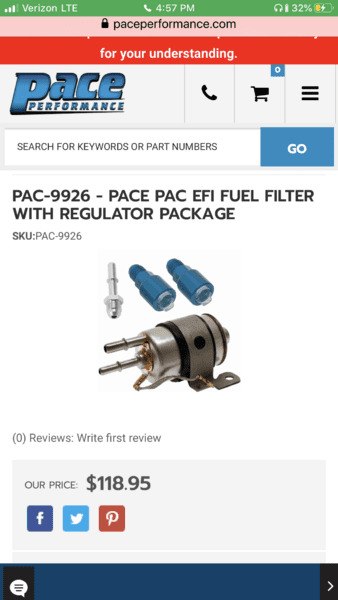

PACE Performance - PAC-9926 - Pace Pac EFI Fuel Filter with Regulator Package
Injectors are the same. That regulator is what I have. I had it on the truck intake before I put the 6.1 intake on. What fuel pump are you using. Is it in the tank or external.
External its a generic in line that is putting putting out 100psi and needs a regulator but my regulator bleeds pressure dowm fast and is all over the place. Is also pressureizzing the gas tank. I think its returning all the fuel to the tank.
