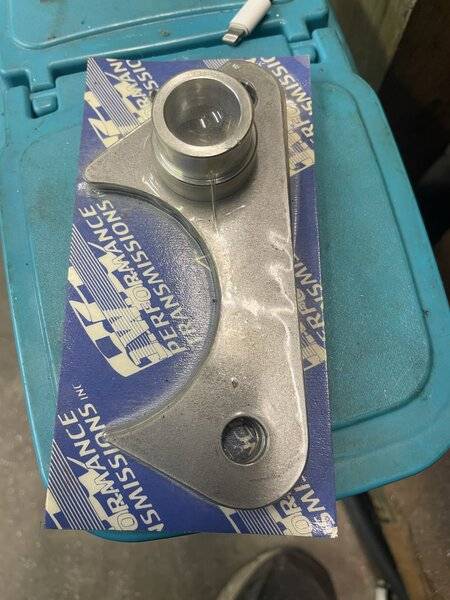

Hello, I am going to a powerglide in my Dart. It's is getting a JW Bell so It will bolt up nicely, however I am also installing a mid plate (1/4") which requires a crank spacer and the Chevy flex plate which also requires a crank spacer. Has anyone tackled this before, and if so what length flex plate bolts you used or any other pointers you can give me before I begin this swap.

You are making it sound like you need two crank spacers. You need a flywheel and an adapter. I have several of both that I keep here. Converter bolts are determined after you set your thrust. I’ll find a nice link to post.
If you have a stock firewall, the clearance for the bellhousing bolts will be tight. Probably need longer dowel pins with the midplate too. There are plenty of different size spacers available for the converter bolts.

All good! I'd need a good handfull of parts to have the original complete anyway. What'd you buy as far as internals? Anything fancy? FTI has a good video on mods to stock pumps and Hughes has some good videos as well IMO! More than anything with a glide it's gonna be converter sensitive. On my car I used the adapter for a midplate too.(it's a GM pattern 1/2" thick Coan) What you use for a starter can guide your choice for the flywheel, as there are a few different offsets.

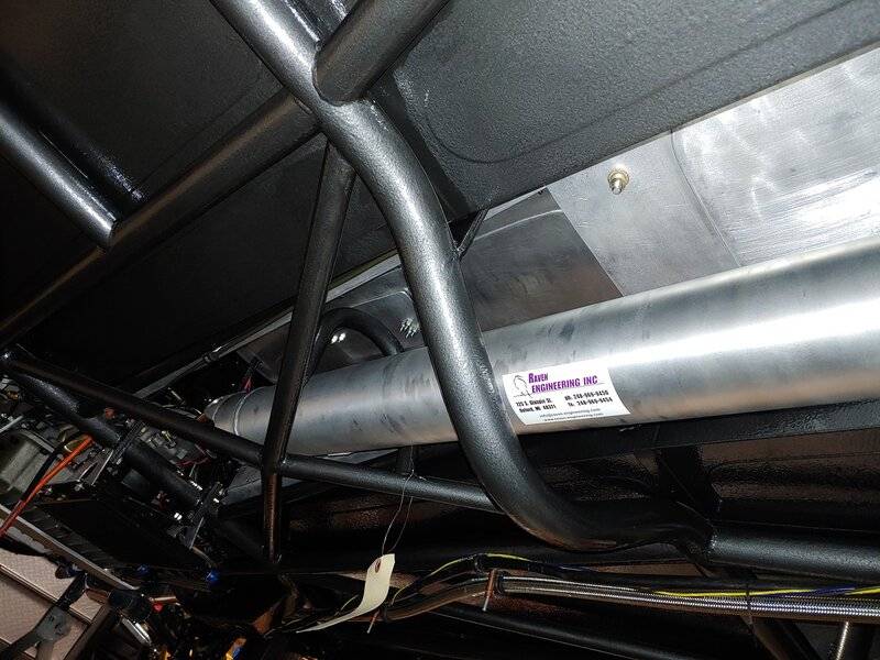

Be sure to take a serious look at the driveshaft. Last car I swapped over to a PG required a carbon fiber driveshaft due to the extra length. Nobody could make an aluminum or steel driveshaft that was safe, had to be carbon fiber. That added a bunch of cost to the swap!
On the Valiant @ 108ish wheelbase, my glide driveshaft was 50.5". I moved the engine back near the firewall which is probably no more than an inch from where a 'bolt-in' intended application would put it otherwise. My trans stack-up is such that it's length is within 1/2" of a stock T400 so I sized the driveshaft for either.
