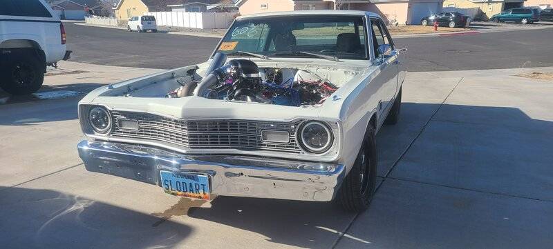

sacrilege ..... but what about a ford thunderbolt bump on the hood?
I was thinking a sunoco hood, still have to notch for the exhaust housing I think. I'm not sure, I'll figure something eventually.
Well... I didn't want to tow it without a hood, let alone sit in a trailer in a hotel parking lot without a hood.
So I made mine fit.
