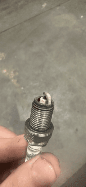

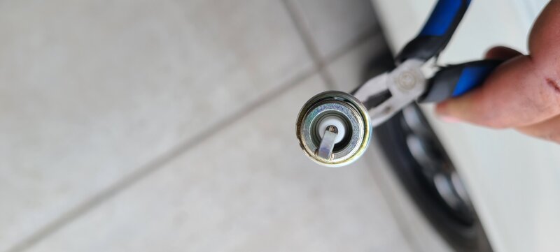

This was 32° I believe. I was still messing with fueling, but this was a couple of wot passes on the highway next to my house.
E85 sure burns clean.
I don't think I took pictures of the 34 plug test. But the mark is just on the bend of the strap.

I forgot you’re running close to 12:1 compression on this thing. I’m surprised it wants that much timing, but the plug looks happy/safe to me! Have you verified the ethanol percentage of your e85?

That plug looks extremely safe. You could probably add 2-3 degrees to your total. From some quick math;
30 less .5/psi after 2 on 7.1 psi.
(7.1-2) x .5 = 2.55
30-2.55=27.45 degrees.
I’d lock the timing at the track and play with it in 1 degree increments for best mph. Don’t worry about ET just run it out every time. Then build a new curve to get there for street driving.
9.2:1 on gasoline at 7psi, this pull was on 30 degrees. The timing mark was a touch to far around the bend to be completely safe in my opinion. I run this engine at 29 degrees at 10psi currently.

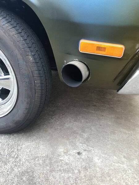

I couldn't handle the hater pipe... it was so obnoxious. Rattle your brain obnoxious.
So I fixed it.
My down pipe comes out in a similar spot. Was worried about fumes but it’s been fine.

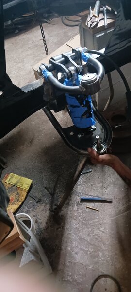

Currently I have a alignment and steering issue.. its just all sorts of jacked up and the guy at the shop isn't hopeful he can get the alignment done. I dunno, adjustable control Arms, adjustable strut rods, all the jazz. He's still not sure if he can make it work. Frustrating.
The Alignment came out pretty damn good. Much easier to drive.

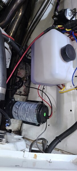

I also decided since I've put the car back on pump gas, a water/meth system would be nice to have. So I have made my own kit.
I picked up a cheap washer fluid/overflow tank from amazon (Dorman), an AEM 200psi pump, 10gph Snow performance nozzle and 90 degree fitting. I'm not using a controller, but instead purchased an adjustable hobb switch, which turns on about 4psi. So far the system works, unfortunately no one in town has any inexpensive methanol that I can make a 50/50 mix with. So i'm currently working with -30f washer fluid, until I can get or make a real 50/50 mix.

I bought the 4 pack of the Snows Boost Juice 50/50 meth/water mix and haven’t even used the first bottle completely. It lasts pretty long unless you’re daily driving and constantly spraying the stuff. It’s like $50 on Summit.
Yea. They just don't have it in stock at my location. I live down the road from a Summit. But that is what I'm going to order. Only way to make my own at a decent cost would be 55g drums of methanol amd some distilled water. But I don't think I'll use all 110ish gallons it would make.
At least for now the -30 fluid has at least 30% ish methanol in it. I might add another nozzle in the volute. I feel much better now about the air charge, I might just turn up the boost and find the limit of my transmission. Lol
