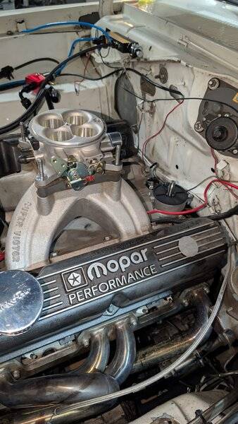

I use a trigger wheel cut from the CAD diagram Subcom sent me. It cost me under $40 to have it made. I probably have the diagram if he can’t find it. I use an unmodified magnum distributor; cap and everything! I went with a 4150 style throttle body because I wanted to retain my carb hat and existing charge pipe configuration. There is also airflow distribution to consider when converting a carburetor manifold which tilted my decision towards 4150.

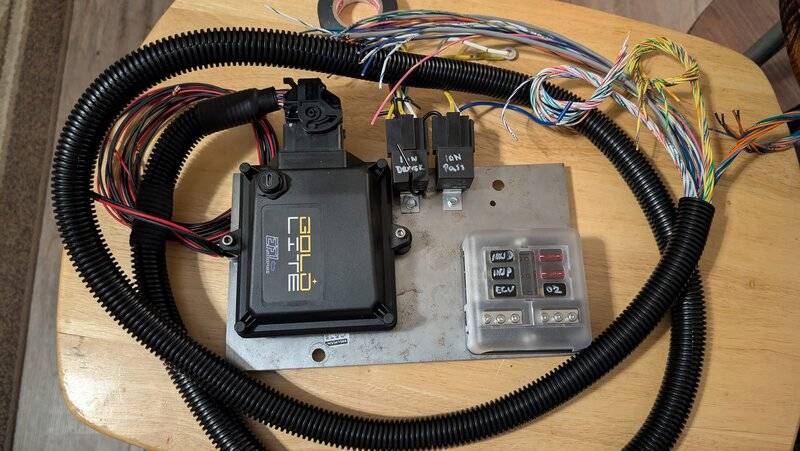

As far as I/O on the ms3 gold lite, so far it looks like it will handle what I need at the moment. But it also boasts the ability of adding a can us expansion module. But I have been eyeing the normal gol
d box too.

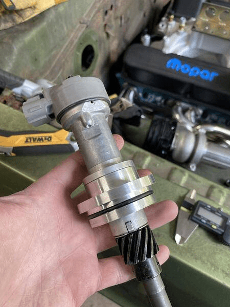

Here's my setup for the cam sync sensor. It's off a Jeep 4.0, mid-90s I think, with an aluminum adapter.

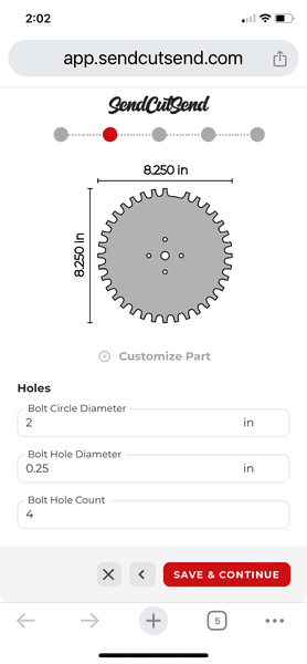

Here’s another handy option for your trigger wheel I discovered the other day. Sendcutsend has a 36-1 trigger wheel template that can be customized.

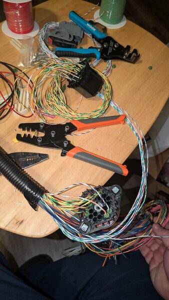

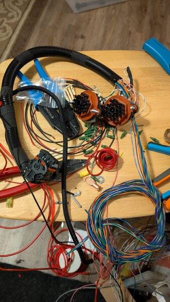

More bits. Lots of connectors and wiring showing up. Also thinking about running a blank dash insert and cutting it to fit a NexgenEFI digital dash. Will clean up all my random gauges and make it nicer.
More wiring, more parts, mocking stuff up. Waiting for a black friday or holiday deal to get the intake and fuel rails. Then it's just wiring and little bits.

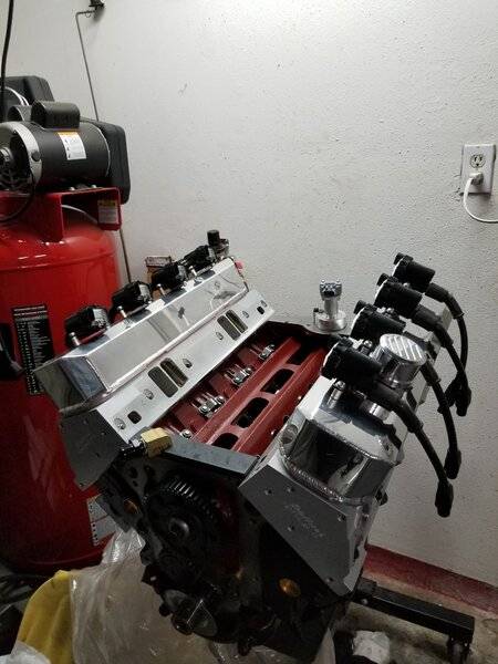

Any ideas on how to mount the ls coils?
I see the remote mount brackets, but I don't really have any good places to fit them. Make a bracket and bolt it to my fabricated aluminum valve covers?

I got cheap alu brackets and welded them to my valve covers. I wanted to add an oil fill cap and AN bungs for pcv so I figured while I had them off for welding I’d just weld the brackets on as well.
Just sent these off to be cut. I made them to bolt to the Magnum valve covers using long spacers but could be adapted to LA easily. Just a simple 1/8” aluminum plate with holes to mount the D585 coils using 1/2” standoffs. Hopefully they fit OK.
I was thinking about doing the same thing and using long aluminum tube spacers. But the fabricated valve covers I have are tall and use the Allen head bolts. Might have to buy a cheap set of covers or do what dnasty did and weld mounts on the covers.
Mad dart just drilled and tapped the mounts when he had my car for the older style LS coils, I just had to make an adaptor plate for the newer style then blue lock tight the bolts. Top pic old style, bottom new style

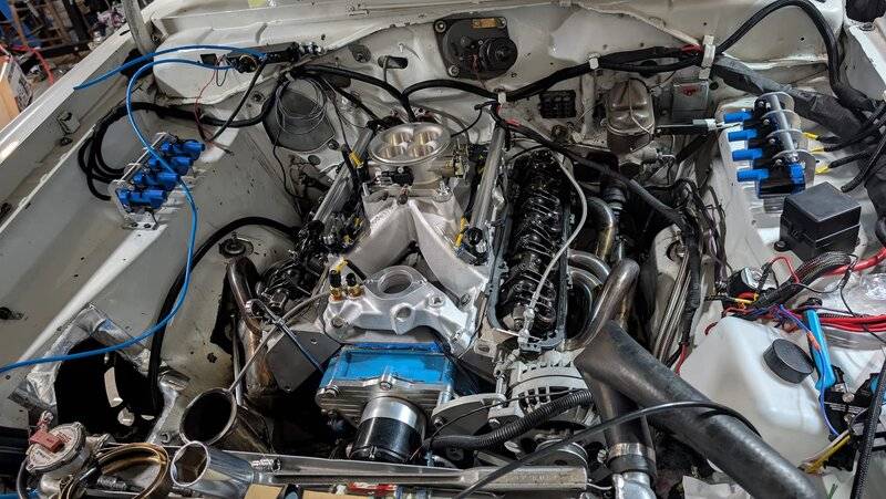

There is fire... it runs.. Like total poo, but it's something to start with. Just want to make sure everything is functional before I re-tuck my wiring. I'll probably swap over to my blue fabricated valve covers too.. Sits lower than the old setup too, but that made my little charge pipe even smaller. Some modification is needed.

Check the basics before you tidy up the wiring. Make sure injectors and coils are wired in the correct order with correct outputs. Use the test feature in TunerStudio to confirm. If that looks good, run the tooth logger and make sure your crank and cam sensors look stable. Check timing also and maybe pull the relay on the meth pump until you get that sorted. Good luck!
yeah i've already had to fix some odd miswirings that I don't think I did.. I believe the harness I bought was crossed, but it's fixed. the meth pump only turns on when the ecu is off but the key is on, but functions properly when key and ecu are powered on.. the key doesn't power my ignition or computer. So it's just kinda weird that the computer outputs revert to ground when off. But that's an easy fix, I can run the 12V trigger wire for the relay to the meth pump to the fuse assembly that powers on with the ecu. I also need to wire up the oil pressure transducer.
I've done tooth loggers, everything looks like it's supposed to I guess. It fires, but the tooth #1 angle is super weird, I did what the manual said and put it in the 30degree number that it is (tdc is 3 tooth gaps to the sensor) but it's like 50 degrees retarded. I put it at 0 tooth angle and the timing light shows it at 0 degrees tdc. Changed the angle to 358 and it's advanced about 30ish degrees. So i'm still playing with it, but it does start the best at 358. Gotta figure out the whole IAC setup and idle stuff, but i'll get there eventually.
