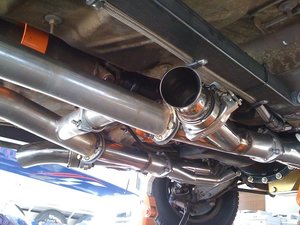

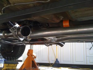

TTI Headers, H-Pipe all 3" and Dyno Max Mufflers dumped at the axle. The only reason I ran the H is because my original plan was to do a gear vendor overdrive and with the X Pipe it will not fit. Plans have changed though, would run an X if I did it all over again.

What brand cutouts are you running on that? I was looking into electrics but didn't know which was better.
All electric cut outs have issues I know guys with all kinds of brands. Motors go out leak grease and flaps get loose. Yes and even QTP's have issues!
I bought mine on eBay a long time ago with the turn downs clamps etc, forgot the brand.
