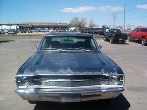

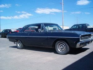

My Barracuda is a late 68 build (June `68) and the rear glass is coded with a date of 6-68. My 68 Dart is a real early build (August `67) and the sideview mirror is coded J7 which is July `67. You might be able to close in on a build date by decoding your glass. Anything past a July `68 date and you`re likely to have a `69. Does your car have round sidemarker lights/patches where there were marker lights or rectangular? You should have a part of the VIN stamped on the engine and transmission if the engine/transmission is part of an original drivetrain.
I wouldn't necessarily assume it's stolen just cause the vin may have been added to a different car don't get me wrong it's certainly possible but it could have just as easily been a sentimental thing, The original owner may have wrecked their 68, bought the 69 and switched the vin number over to feel like they still had their original car. I know quite a few guys who have done that (I don't really understand the reasoning but it's their car) Also you said the rear marker lights are welded over can you tell if they were 68 or 69 markers maybe its a 68 that got wrecked in the front end and someone bought a 69 to fix it and decided to put all the 69 trim on it. P.S. post some more pics and did you ever find out what year doors you have. Let us know Justin
the door locks are forward of the handle. That would make sense someone swapping the dash. It would be a lot of work to switch everything else over. Works out pretty good for me being registered as a 68. no more emissions! I do like the power bulge hood also.

You say the quarter marker holes were closed up? but harness in the trunk? are you sure the holes were there? if so, it looks like someone hung a 69 front clip on a 68 Dart... The hood would be the same regardless... but I can tell you from experience a 69 grille and bezels will not go on 68 fenders (without one hell of a fight LOL) also, do you have a pic with the hood open? the hood latch plate on the core support is differant from 68 to 69.. the latch itself is the same, and located in the same spot.. but the plate around it is differant to accomodate the grille... As I said, I speak from a small amount of experience.. when I got my 69 Dart the fenders were off of it... they were beyond fixing.. I found a set of 68 fenders and as far as I could tell, besides the marker hole they were the same... WRONG LOL ... turns out the headlight buckets are in a slightly differant spot.. and the very top of the fender where the grille and bezels mount is differant as well.. However, I have a VERY limited hot rod budget.. so it took some work, but the 68 fenders got me on the road... still on there today .. If you find 68 fenders and want to get rid of those 69's let me know ... lol..
I agree with the rest of the gang, I am not sure its a rare find as much as it is a car that got pieced together to cruise... build it how you want and have a blast!!
