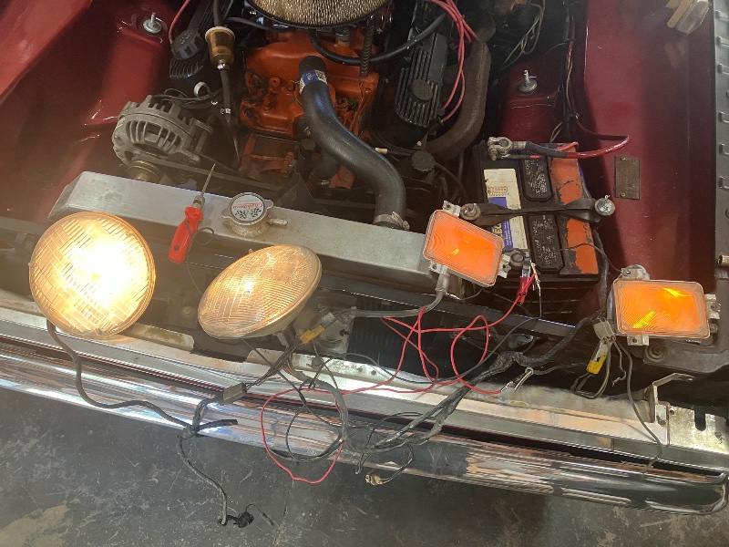

Partial success.

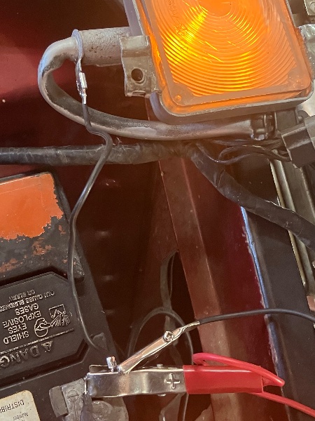

The headlight switch has that tang so I added a short 18 gauge ground wire…
It runs to the underside of the dash frame to the right of the fuse panel.

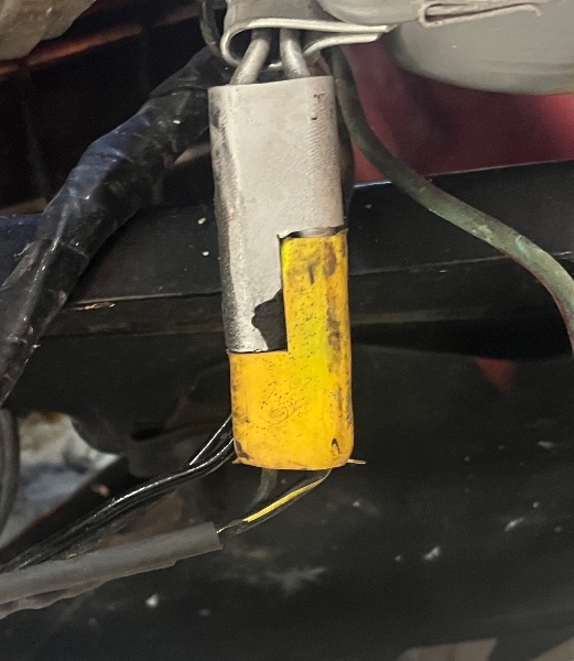

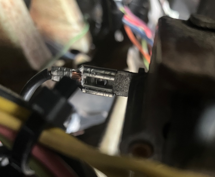

Everything lights up. I had to make adapters for the turn signals since the 69 signals have terminals like this:
The wire harness has terminals like these:

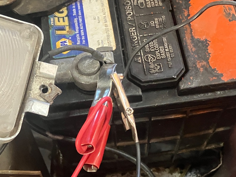

The 69 lenses have ground tabs on the side of the sockets.
If they are touched to negative, it all lights up.
I don’t know if the brake lights work. The taillights don’t. I’ll test turn signals next.
I have power to the trunk!
I did see that the taillights do work. The turn signals in back are faint but do work, the left side is not consistent. The right side only get a brake light and turn.
No turn signals up front, they stay lit but don’t flash. My guess is the turn signal switch is to blame.
I’m happy to have the front working though.
More work to do…
