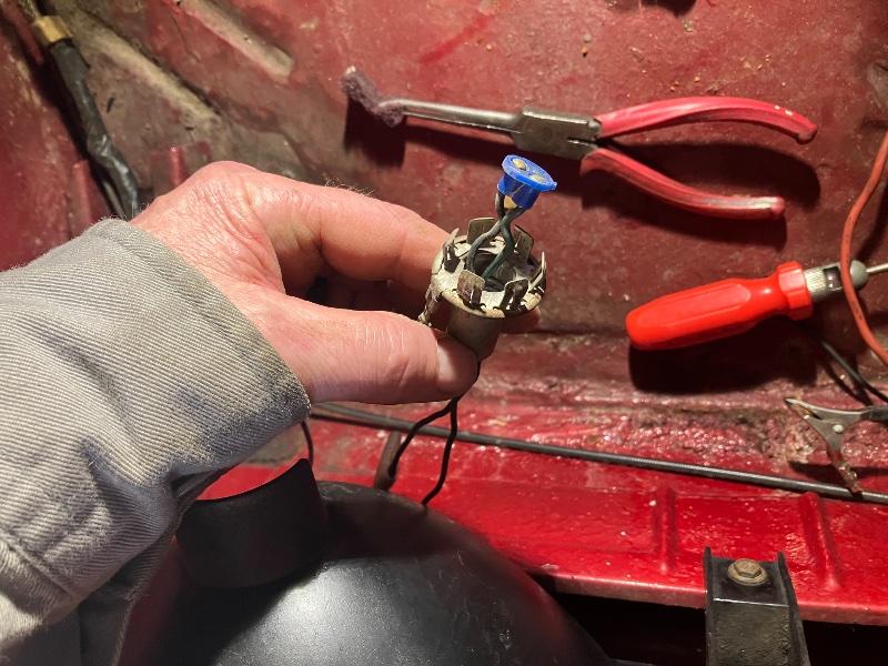

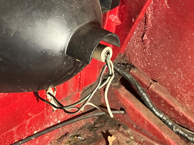

1972 did have a few small unique things. The plastic housings used the external ground with a tab on the outer edges of the bulb socket.
This is the only year that I have seen that has this two wire terminal to a blue colored collar. Sort of weird.
Looking close, there is a tab to index the collar in the socket to get the bulb to make contact with the “contacts”.
If that collar is out of position, the bulb’s contacts won’t touch, no light. There are three indentations, two are for the pins on the side of the bulb housing, one is to index the collar.
I did have power to the wires.
The inside of the socket was cleaned with a Scotch Brite, the collar was put in properly and….
